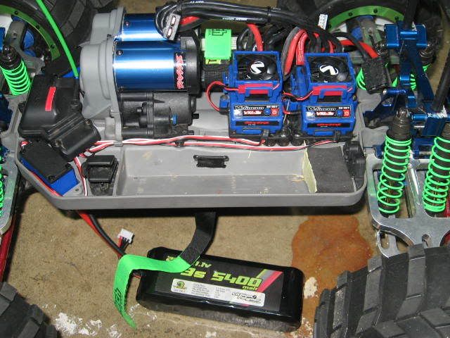

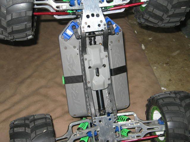

here is how i ran my setup when i had my 3905, i was extreamly happy with it.
Hope that helps..

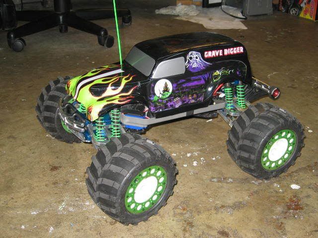

here one with the body on.. This was a cool truck..
Hope that helps..

That is looks great! I think for the moment I'll just run with noraml 4s and later (when I get more money and more parts) and I always move up to 6s :) Thanks for the pics though, those show exactly how I was thinking of doing it.
