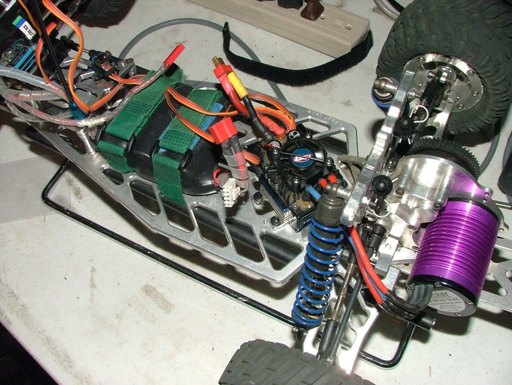

I am using the Losi 1/8 ESC in my Rustler and it works good now with the latest firmware installed. For the life of me I couldn't get the AM radio to work properly with the ESC, but the 2.4ghz radio had no issues. With the new firmware, some settings have changed, cogging dissappeared, and an AM TX/RX setup works with no problems.

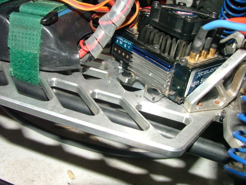

Personally I like the casing and wrap around heatsink better then the cheapo looking one from Castle. The losi ESC comes with those 4mm socket connectors instead of some wires like the Qaurk, MGM, Castle and LT controllers. Software is not as refined as the Castle one, but it isn't bad either. Uploading the firmware takes longer then the Castle products, but how often do you really upgrade firmware?

The ESC is rated for 3000kv max. However, I used a 3600 c50 hacker with no problems. My 6yr old son raced/drove the Rustler today for about 20 minutes with that esc on 6s A123 and 1400kv tekno.

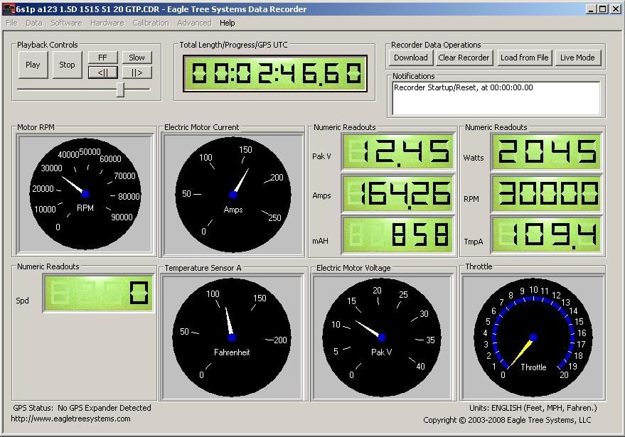

Datalog of my GTP with the LOSI 1/8 ESC before I busted the front diff. Brakes set on 10 percent and nimh mode. Motor used was 1515 2700kv and 51/20 gearing. The ESC keeps its cool and still performs well.
