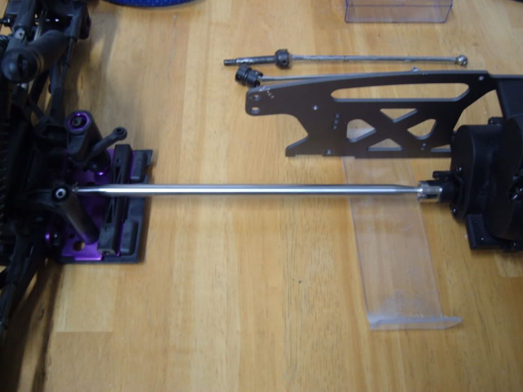

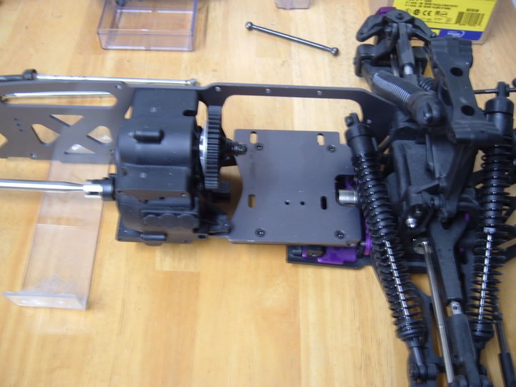

But back to this, a 3rd project that should be reasonably interesting. Basically going to build a long chassis for savage front and rear assemblies. I plan to use a flux single speed tranny, with a flux motor mount and a neu 1527.

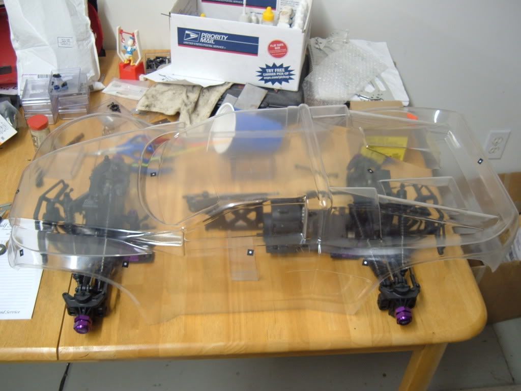

I already have the body, it is the proline desert rat 5t body: http://www3.towerhobbies.com/cgi-bin...&I=LXWKP5&P=ML
So the plan is to use a custom rc alloy's front center driveshaft, and a savage xl rear driveshaft to span between the flux tranny and the diffs. I have the rc alloys shaft and need to determine if the xl rear shaft will work with this body. Measurements were made with the hpi 5t body, which has a slightly different wheelbase. So we will see what the mockup shows.
Battery placement will be in front of the tranny for proper weight distribution. The motor and esc will sit behind the tranny as in the flux.
Now, of course this is inspired by HPI japan's savage 5t, no doubt about that. Since I do not plan to buy 24mm hexes and 5t wheels/tires, I will use some proline 23mm 40 series beadlocks and some sort of 40 series tires. I plan to narrow the beadlocks, and most likely narrow the tires too, most likely to something similar to the width of the std MT tire (such as a badland tire). This should be closer to the width of the Baja 5t tires, and maintain the scale-ish corr truck look.

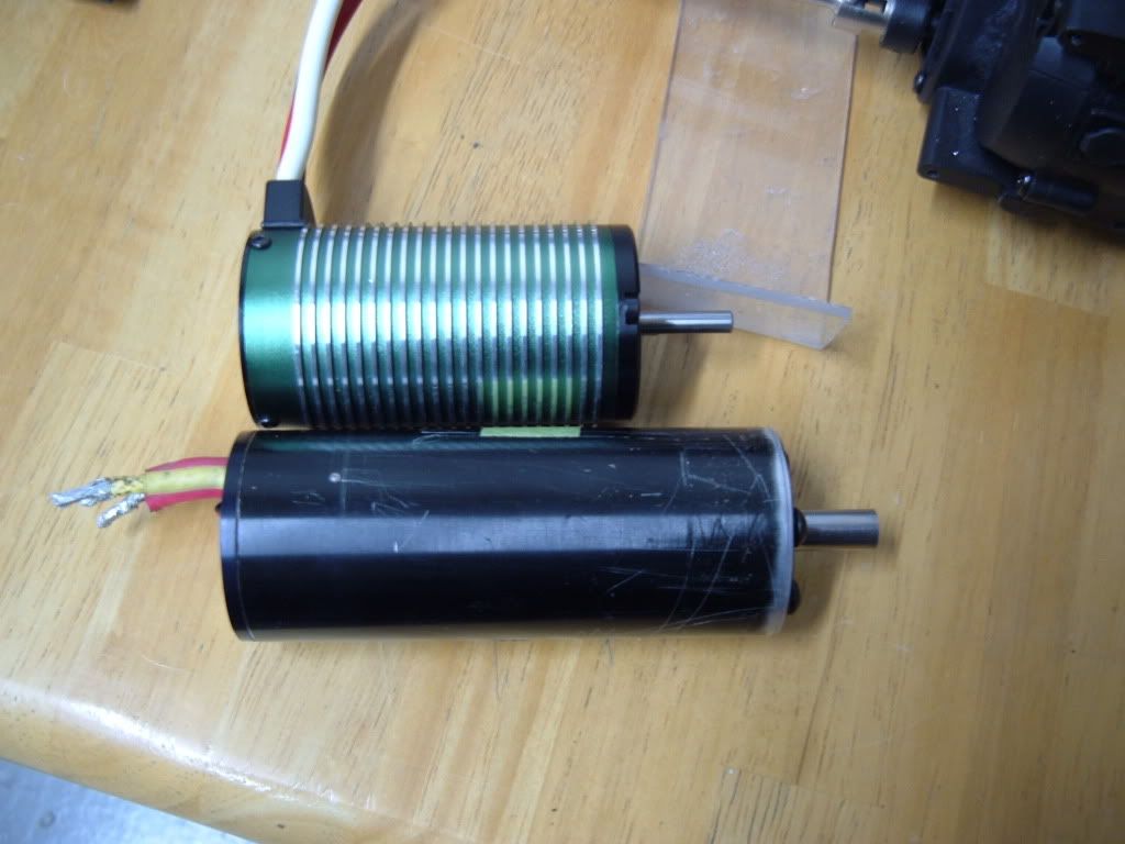

I do not plan for this to be very heavy, maybe around 13-14lbs complete. So I think that I can get away with a single 1527 2y motor, and 12s lipo, both of which I have. I do not think that I will need a multi speed tranny, but mech brakes may be a requirement. So that means that I will not have reverse... I will gear it for around 40mph.

Anyways, looks like I will definitely need a xl rear driveshaft, the std x/flux rear driveshaft is a bit short... So I will have a look for a good deal on ebay!

Ok, heres a few pics. The chassis shown has one flux tvp, and you can see it is a bit short with the front axle lined up with the center of the front wheel well. You can also see the "gangsta" custom shaft from rcalloys! "Very Nice, I like!" It is much better than my sister, who is #4 prostitute in all of Kazakhstan!
And the last pic shows the 1527 compared to a cc/neu 2200. It was in a ducted fan jet that routinely went past 150 mph! Zing! That is a 2y motor with 8mm shaft and m4 threads. Beastly!
