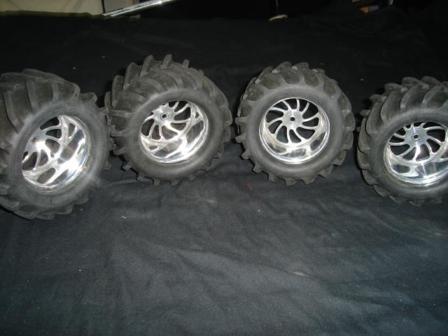

next is to mount up my SPI aluminum 1" deep dish off set wheels for 2" wider stance without using those cheesy extensions that tend to break and look like garbage.

i've been wanting some of those spi wheels. How do you like them? What'd you pay?

I got the wheels off a maxx I bought from feabay 6months before the 3905 maxx came out that had them on it with a nice custom painted body, roll cage, cvd's, 7 cell 3300 gp batts "before lipos were being used by many people"
I love the wheels they give you less turning radius but super stable turns....the truck will slide vs flip over as much and with alloy hex's you dont strip wheels plus life time warrenty through spi
Ill post pics when I can
