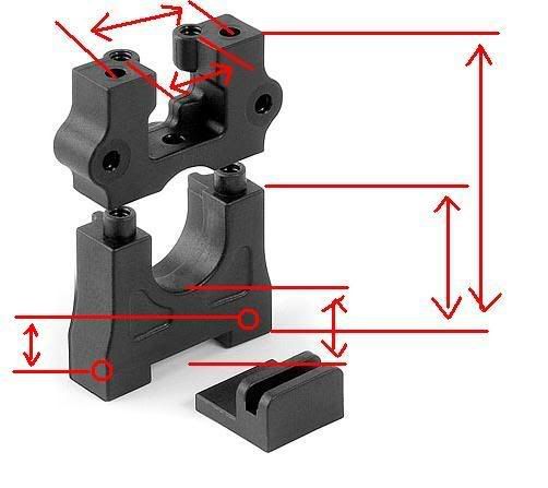

Could someone that has 808 mount, get me these dimensions?
To run the 808 mount you would need to run a smaller spur. Its sized to work with the 42T center gear on the 808. The XT8 runs 48T. I had to shim the 808 mount up 2mm to run the 46T slipperential in it so you would have to shim it anothe mm or 2 beyond that to run the 48T center gear.

I cant deside what motormount to use, obviously 808 wont fit, so which mount to use Tekno or RCM.
Both has up and down side, Tekno needs holes to chassis but centerdiff is easy to remove. RCM is bolt on solution but removing centerdiff is PITA.
All rcm mounts should be designed like 808, its great desing!
Or should i get RCM mount and try to mod it, so that it uses stock upper part?
The 808 style mounts are cool, but 3 pieces instead of one - means 3x as many operations to make them and 3x as many fixtures and 3x as long to machine. This is a lot of work - especially when you consider that removing the center diff on a 1 piece mount only requires removing 1 more screw than the 808 style mount requires - basically about 20 extra seconds?
