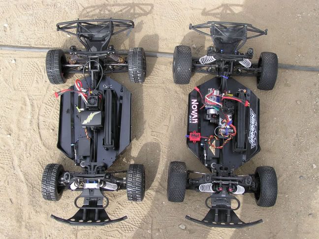

Started working on putting the kit together. Added a Mamba Max and Neu 1509/2D motor. Good news is most of the parts are the same as the CRT.5 so I am moving over a bunch of cnc parts (steering rack, spindles, c-hubs, wheel hex, etc). This also means replacement parts will be easy to get since the CRT.5 has been out for a while. Bad news (at least for me) is that the Battery will only hold a 2s lipo pack. I guess this is ok if you will be running a smaller brushless motor and 2s, but I want to use my Neu 1509 on 3s. I was running the Neu and 3s in my modded CRT.5 and it was a rocket and ran very cool, so I moved my custom carbon fiber battery tray over to the SCRT10 so I could use a 2s or 3s battery.
Optional parts
CRT.5 compared to the SCRT10

How much longer is the chassis than your crt.5
brushlessboy16
brushlessboy16's Avatar
12.19.2009, 07:04 PM
stock crt.5 has a wheelbase of 8.8in
Scrt is 12.75in
