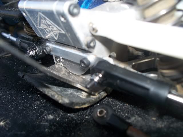

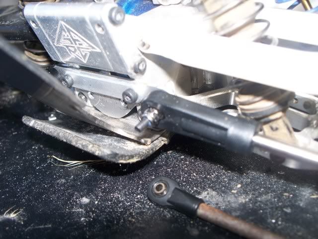

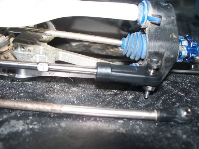

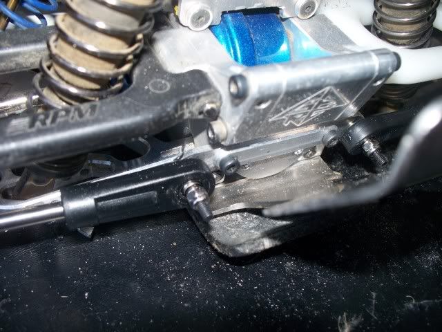

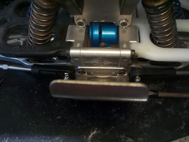

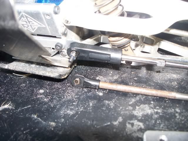

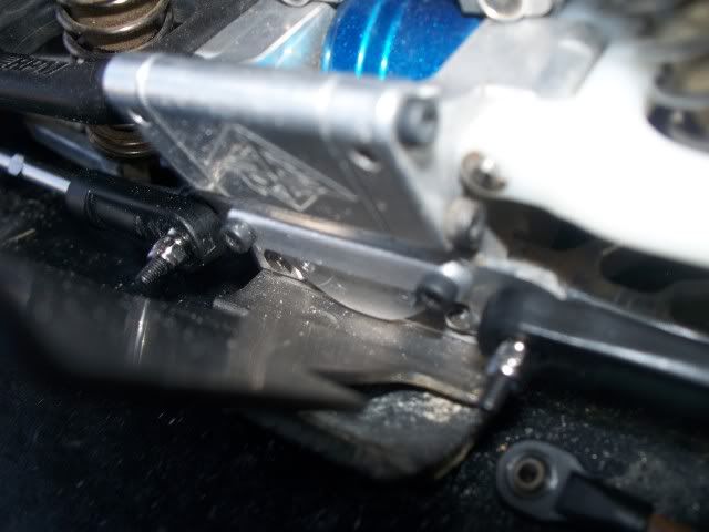

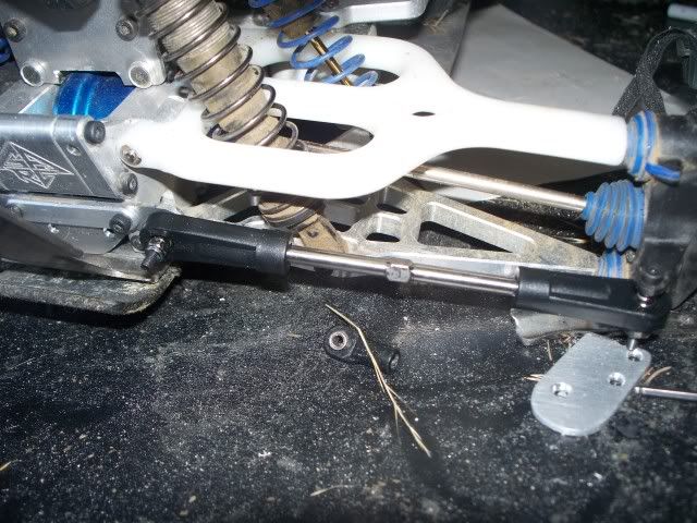

Well for an Update, I bought:
Ball End Plastic Rear Upper Arm (OFN40065) X2 So I have some spares
Ball, 7mm: 9.5, MBX (OFN36850)
Ti Turbuckle 5mmx90mm (LNS1590) X2
Total Cost Was $26.00
My Dad has an LX-1e and the rear upper arms are 7mm ball ends with 3mm holes that are Extremely beefy. So I measured what I needed and ordered the best I could get: Ti turnbuckles.
Well they were so big that they took a bit of modding to get to fit right. I had some 3mm 7075 pieces laying around and used them to make a great little mount for them.
After a few Beers and a dremel bit or two later I think they look GREAT. I was going to take pics along the way but the Gf is gone witht the camera. I am off tomorow and will get a some pics for you all.
The Turnbuckles are beefy and SUPER Lightweight. gotta love Ti. and the BALL ENDS Are about 300% larger than the upgraded Revo ball ends. HAHA SICK! Will update you guys tomorrow with pics...
The Dual Toe Links did not bind, but dramatically changed the geometry of the rear suspension when compressed. I did not like that.

05.29.2010, 06:05 PM
MMmmm Beefy...

05.29.2010, 06:06 PM

That looks cool and all, but why didn't you just get Ti Toe-Links that were the right length instead of having to make a custom bracket to mount them? Lunsford makes 3mm, 3.5mm, 4mm, 4.5mm, & 5mm Ti Toe-Links for the Maxx...they even make a 1/8 scale titanium turnbuckle & toe-link conversion for the Maxx, with super-beefy links and rod-ends.

05.31.2010, 06:45 AM
Well the Turnbuckles fit fine lengthwise in the stock location. I had originally planned/Measured the pieces to fit in that location. But found they came into contact with the Rear bulkhead where the braces are screwed into, when the suspension was fully compressed.
I could have used a spacer to clear it. But I had these scraps of AL laying around, and like making stuff like this... So I just threaded the link further down the turnbuckles... These Ends are HUGE.
I knew about the Lunsford kit. But these Ends are way bigger still... Plus this only cost me $26 bucks shipped with extra rod ends.
Oh AND BASH REPORT: Everything works very well! Ran for 2 packs and the only thing that happened is the Nut holding the ball End Came Loose. So I lock-tite and added a Second nut. Now this thing is solid... Thanks for looking/Comments
