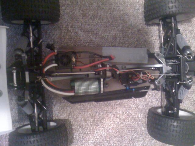

Hey all i'm new to the forum been into R/C on and off for about 20 years but just recently converted my ST Pro to Brushless.
I see all kinds of threads on the ST Pro here just wonder what the "most common gearing" seems to be.
I am running CC MMM 2200KV and have tried 13T, 14T, 15T, and 17T just wondering what kind of Temps are considered "safe" as I have heard everything from 140 to 200 degrees depending who you ask.
This will be a 4S setup cause I tried 6S with the 17T pinion and literally blew the tires of the front rims.
I guess i'm just trying to find a good starting point and i'll go from there any help greatly appreciated
Have attached a crappy iphone pic
