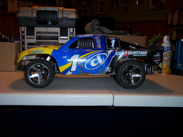

I have an FML Rustler extended wheelbase chassis. Wondering what bodies fit good on it?
Right now I have a slash body on it. It fit's "okay", but the slash is (roughly) a 13" wheelbase, and I have a 12" wheelbase.
So far the best option I have found is the JConcepts BAJR body.
I like the looks of the short course truck bodies, but I'm doing speed runs....so probably not the best idea.
I'm running a VXL system on 3S lipo and a 2.4 radio.

For serious speed runs with that chassis, you will need a buggy body and both front and rear spoilers. If you get some wheel adapters you can put a 1/8 scale onroad body on it.

The Kyosho Aston Martin body fits perfect over my extended Rustler. With the narrower buggy tires the tires wil tuck. However, I have the older bulkhead, which had the extended option. I don't know if the new FLM Rustler is a tad longer that the older version to make up for the bulkhead extension difference.

I recently found out about putting vent holes in the rear of the slash body to cure the "lift-off" issue.
So I've actually been able to top-out my car....probably more left in it though.
