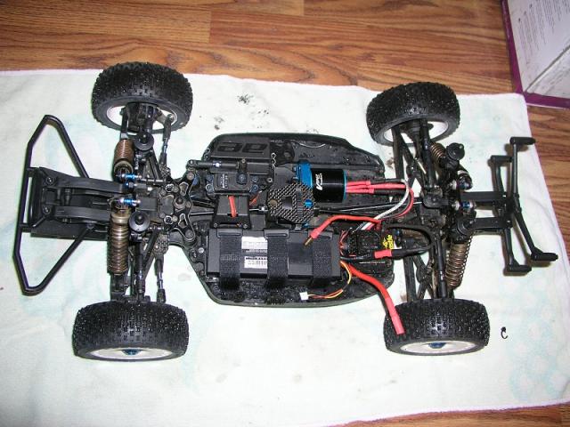

During the time i builded my SC10 4x4 RC8 based
i tested 2S in that car and i was quit impressed how good it worked
I had a Tenshock 2220/7 4300KV laying around
Same gearing as for 2200KV on 4S 16/46
Just drove done the road, but wasn't slow at all and had enough punch
Was smooth driving
I bet, the CC 1410 from the SCT Kit would do a good Job here as well
Setup
2S 6500mAh 60C
CC MMP
Gearing 46/16 AE RC8 ex Nitro
kind regards
Mirko

outlaw
Castle addicted
outlaw's Avatar
Posts: 146
Join Date: Dec 2010
Location: Hamburg, Germany
01.24.2011, 09:52 AM
Some Datalogs
TS 2220/7 4300KV on 2S in my RC8
Gearing 44/16
almost 180 A and close to 1200 Watt ...
kind regards
Mirko

01.24.2011, 12:54 PM
Assuming that 180A spike happened at the same time as the 1200w spike, that means the voltage was at 3.33v/cell on a 2s pack. Not too bad if that voltage is at the end of the run, but if anywhere else on the graph, that tells me the current is too high for the pack and would benefit from using 3s and more moderate gearing.
High currents are hard on everything, and is less efficient (heat losses).
Just my $0.02.

outlaw
Castle addicted
outlaw's Avatar
Posts: 146
Join Date: Dec 2010
01.24.2011, 01:04 PM
Jep the voltage dropped to 3,3 V
Was just a test for that little 40mm Motor....
3S would be not a bad idea...
On 3S the Motor will do about 45K
So 50/12 gearing should give me about the same speed as me 2240/5 Setup on 44/14
I will try that on friday
Guess 1200 Watt should be enough for that car...
kind regards
Mirko
Brushless motors have to be green ....
