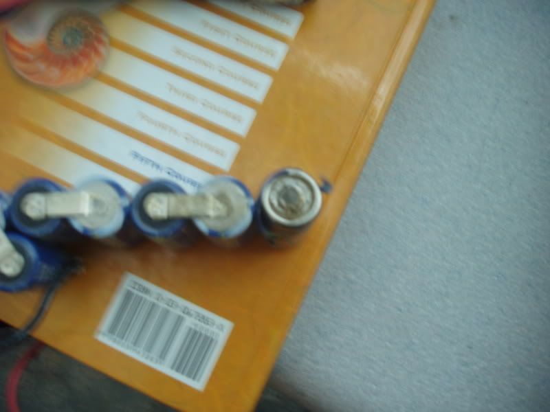

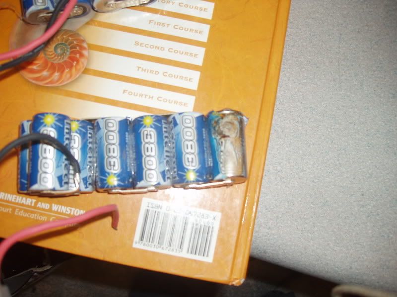

hey i just got a couple pics of those batteries that i was talking about that got messed up. tell me if these are fixable
http://i86.photobucket.com/albums/k9...baypics147.jpg
http://i86.photobucket.com/albums/k9...baypics146.jpg
http://i86.photobucket.com/albums/k9...baypics145.jpg

I dont suggest using those. Your car/truck is only as good as the batteries you use.
I would say go to your local radioshack and get some gp 3300 6 cell ni-mh packs. They are the best bang for your buck. I have three sets of them and rebuilt two of them to side by side.
Also the batteries that got messed up are fixable. Just replace the bad cell.
