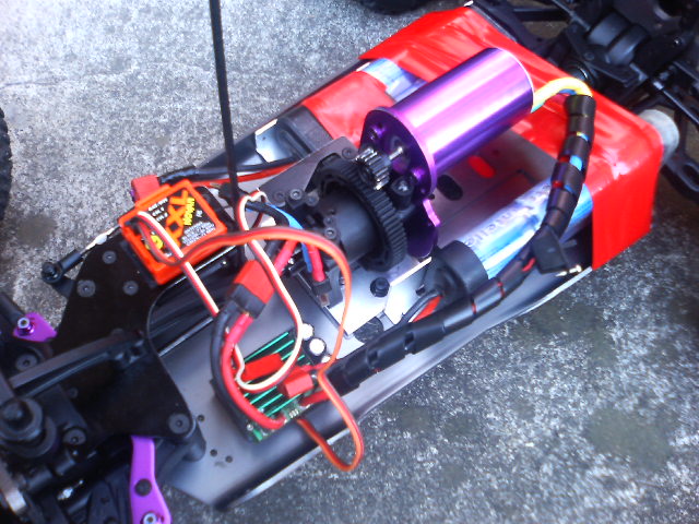

...for whats its worth i stood them on their side in the Hellfire...Laid down they were too wide for my liking...This was regular 6-cell nimhs...
