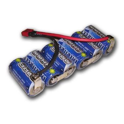

I'm running 16 GP3300's only because I'm buying my brushless system now and don't have the additional to invest in a new charger, balancer, and lipo packs (could total $400+ quite easily!)
I will move to Li-Po at some point though!
(unless you want to buy newly assembled GP3300 packs????)

Originally Posted by Sylvester
Where did you get those gp33's, procharged?
I bought (4) six-cell side-by-side from max amps before they ran out. I have (2) new unassembled packs of 3300's and a set of lightly used 8-cell side-by-side as well.
all of the 6 cell 3300's are new/never used. I'd consider selling them and moving up to li-po/li-ion if someone were interested.
ID:	2152   Click image for larger version
ID:	2153   Click image for larger version
