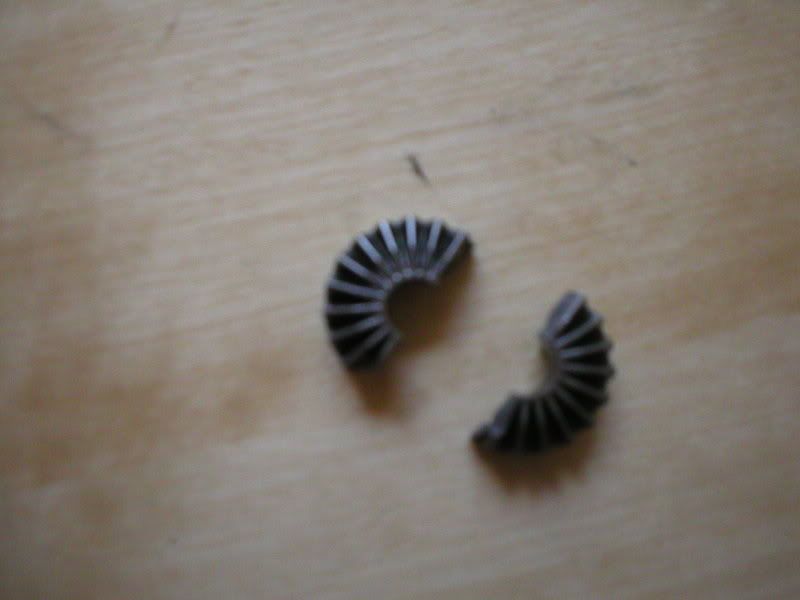

2.) i Have these diffs. i broke this
What part number or part name is this called and where and can i order/get it singly. Thanks guys

here you go; http://www.hbeurope.com/piw.php?part...8101-1&lang=en
its called spider gear, or satelite gear.

Impressive damage! i never managed to get one look like this..
On my diffs it are the pins that break..

Thanks serum. this was actually man made damage i was trying to pry it of of the custom adapter i made to use the sliders for revo stubs. i was in a hurry and instead of cutting them with a grinder wheel or cutting wheel i used lock cutters to cut them and this made a very tight fit and lots of hammering was required to fit it to the gear. once together i noticed the diff action was very crappy and not as good as one of the better custom shafts i made so i remade some shafts out of revo stubs today, and after i made them i had to install them. SO i had to pry of the old one and i pried so hard on the gear it broke but now i got a good set of shafts and all i need is the gear. BUT anyway serum or any one else do you guys have any opinions on what diff weight i should use in the front while using 10k fluid in the rear. Keep in mind my truck is a tad heaver than most. thanks.
