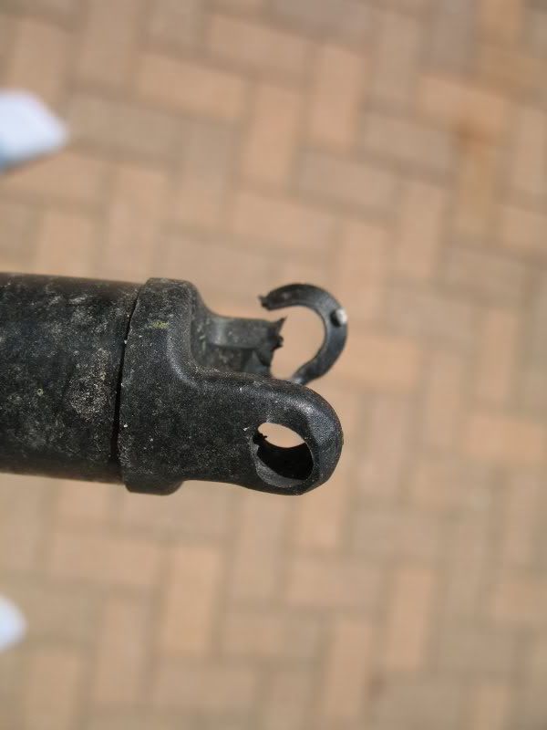

I broke my 3.3 Revo centers in my E-maxx after about 3-5 runs with my Hv-Maxx 6.5 and 2S LiPo :-(
The yokes gave in similar to what Eccentric pic shows.
Would the Revo centers hold up better in an E-Revo then in an E-Maxx ?

I wasn't talking about the center shafts either....
in the center you need either dogbones or cvd's.
Ahh sorry for thredjacking. I was so annoyed breaking my 3.3 centers so I just had to write it somewhere and I guess my brain assumed you guys talking about centers.... :032:
