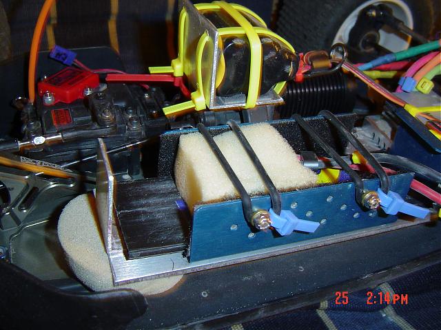

Greetings Skillx! My name is Anthony and I am the guy Elliot was talking to when you were @ T4BB this morning. Thought I would post a couple pics of my batt./ESC mount for you. I used an L shaped piece of allum. mounted to the top of the motor mounts. I found this to be easiest way to clear the side skirt mounting holes. Try to ignore the reciever pack(embarasing), my UBEC went south so I'm making do. If you have anymore questions just post em'; there is a wealth of knowledge to be gained from the brains on this forum, everyone here has helped me out alot.

Forgot two things: I highly recommend the heat sink Mike sells for the 125b. The Quark WILL OVERHEAT without it 9 months out of the year here. And please let me know when you get it ready to race; It'll be nice to have another brushless truggy to run with(trying to pull a battery swap to make a 15 min. main with the nitro's is challenging).
