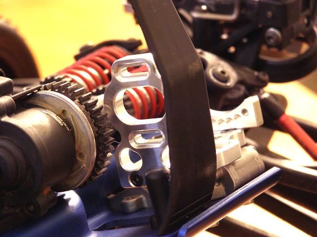

My 3.3 roller arrived today all set for a bl conversion. I have stripped the nitro gear from it, I will get a black wing for it and may try the new Traxxas mount. I'm still up in the air about which motor\esc I will use. I'll be making the jump to lipo for this bad boy too! 4s 8000 mah is the plan.
I've installed the rc-monster motor mount so I can keep the nitro tranny and lower CoG.
I will post updated pics as the project progresses. I have lunsford hinge pin's for it, and a sheet of 3mm carbon fiber I will make the electronics and battery mounts from.

Looks REALLY nice! Why not just dye that wing black? Only cost like $2.

Can't wait to see the finished product....That new motor mount is sweet!

Thanks guys. a 9xl would get me running fastest. I have a ubec and MM sitting in a box. I will wait until late Jan to make that decision though. I want to see if this fabled MMM comes to pass.
I got the CF from www.fullforcerc.com
I will be locking it in second.

oh i see. just wondering how would you cut the cf??
DickyT
11.13.2007, 01:44 AM
I cut some already with my dremel for a couple small pieces for my Rusty. After I mock up the mounts with carboard, i will trace the templates on the cf sheet with sharpie then go to my friends hose. He has a band saw and drill press. I'm going to counter sink the screws on the battery tray If I don't get lazy and get the tekno tray.

Are you going to de-anodize the chassis?

yes, I am. All of the blue aluminum around the truck will be stripped to natural finish.

I'll be starting tonight! I'm stopping by the grocery store on the way home for some easy off oven cleaner and steel wool. I'm expecting a bit of elbow grease to be needed.
