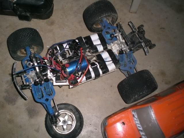

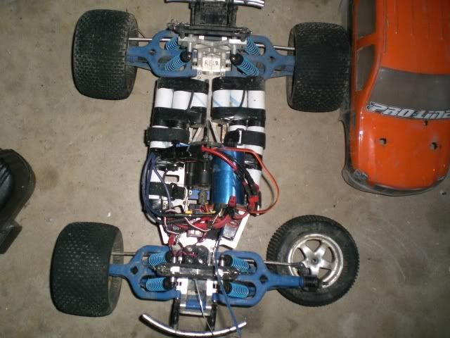

i got my first chance to run my setup today with the new packs i made. it was a bit nasty outside since its been raining for the past two days, but i couldn't wait any longer.
setup is emaxx flm ext chassie, hybrid bulks, hot body hardend diff rear, reg. hot body diff up front, 7k diff lube in both, hardend steel idler gears in stock emaxx 2speed, bk9920 esc, kb45xl 1700kv, 26t pinion, 66t spur, and 6s1c x2 a123 packs.
i didn't know i see this much power go through this truck. i would compair it to my rc18t i had running a wraith7k/quarke33amp on lipo. it's nuts. i had to go to my dad's house since my ditches hold too much water. he has gravel roads that shead water pretty good. even in these conditions (wet gravel and wet grass), i could wheelie and toss the truck around like crazy. i can't wait to get it out on a nice day with dry ground. my dad kept commenting on how much the tires were ballooning, but i lost him when i said thats nothing since they're duct taped on the inside. he was only seeing the sidewalls stretch out. i did get some gear clicking a few times, and i really hope its not in the diffs, i don't know whats stronger and when i hit the asphalt their gunna get a workout. only damage was a lost wheel nut just as i was about to stop and clean her up.
i guess i'll ad some pics. ignor the wireing, it'll be fixed, i just needed to get this thing going again.

yeah, it seemed pretty darn fast. i wasn't able to give full throtle either. i think in need to look at my toe and caster cause i would loose it at high speeds. i was most impressed with it shear over welming power at any speed. i love it. i'm stuck at using 6cell with my esc, but i think its already over the top unless i try to set land speed records with it. i do think i'll upgrade my wires on the batteries and also direct solder my motor and esc. i got a little bit of cutting out a time or to like i was loosing battery connection. i think i may have loosened a connection on my deans from current drawl.
