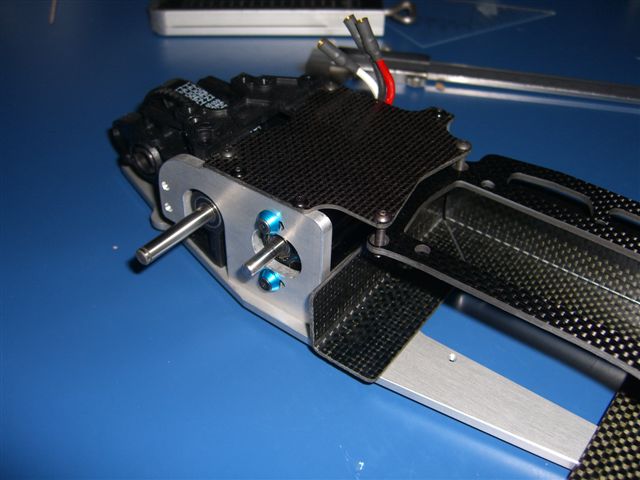

I use M3, M4 taps, scroll saw, rasps (different grades), dremel, drills, scotch brite/waterproof sanding paper, calipers, ruler and some patience.
Easiest thing to do is to draw something, and print it 1:1; that way you can simple put the 'template' on the aluminum with double sided tape and cut away the stuff that's in the way.
A vice is a handy tool too. As is a press drill, but you can manage without both.
you are able to make parts like this fair easy;

Seems like we both make our parts very similarly (print out drawing and double-sided tape it to the material, cut with scroll saw). Except you definitely take more time on yours, getting the edges nicer. I don't finish my parts like that...
You didn't cut that CF with the scroll saw, did you? I haven't had a blade last more than 30sec. on any composite fiber materials (fiberglass, CF, G10, etc).

NO man.. that wasn't my intention.. Just consider what you can make without too expensive tools
That's not showing off, i don't consider myself good at it. Considering the used tools, it's okay though,
this was 10mm thick aluminum, a lot harder to work on. made the x-brace and the holder for the schulze the same way.

No, i cut that carbon with a cutting wheel and the dremel.
