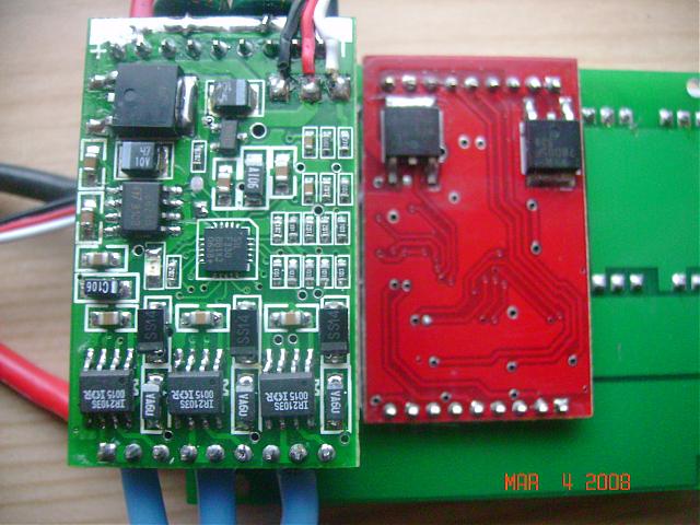

OK, I got the Brain Board lifted.
Here's a picture.
Looks like inductors, do you see any coils inside?
All the rest is clear Fet's drivers with bootstrap caps and diodes.
Also looks like you lost couple via's in process of taking it apart, not good, but can be fixed.
I can try to fix it for you, but later in April :(

I don't see any reasons why not, but looks like you have two DC-DC convertors, so you need to remove diode/inductor/resistors from first one and than check if second one is still working (from smoked inductor I think it is dead too).
So to make it happy again you need to restore 5V and 12V for MCU. How you are going to do that it is up to you. I would rather check datasheet on both DC-DC convertors and fix them properly.
Are you sure MCU is not dead?

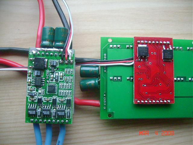

I'm getting trying to figure out who makes the driver of the picture posted by sikeston34m and now I can't find the manufacturer of the MOSFET (Edit: I found the MOSFET manufacturer) of the ESC in the pictures I have attached, but look at the brain board, it looks identical and the onlu differance are a few colors of some components and the drivers are from IRF (IR2103S). Good things will come out of this. I'll go take some pictures of the big car controller with this one to see if we get a match .

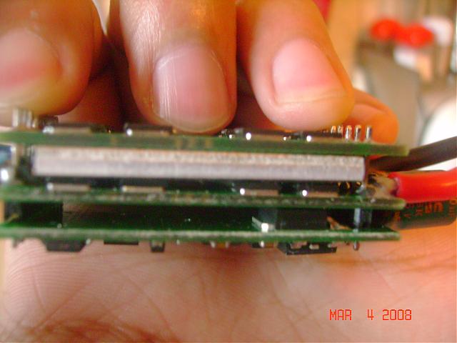

They are the same size, but the little one was closer to the camera and it seems bigger. I also attached a side view of the little controller.
