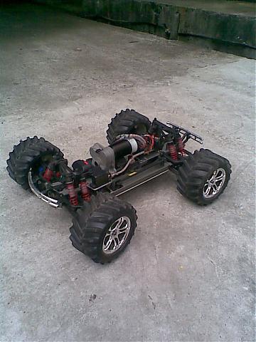

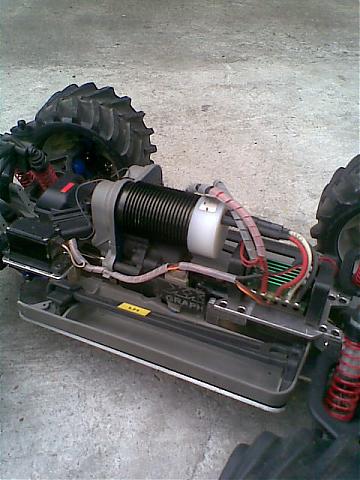

Here's my FRANKEMAXX!!! It's a cross between a gorillamaxx and emaxx2. It has a flat-pan chassis but it retained the original battery tray and holders....It now handles like a truggy!!! I hope you like it...
