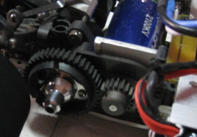

03.06.2009, 09:47 PM
Originally Posted by Countryhick View Post
You mean THIS one???
I still haven't heard of anyone that has one. Did they even release it????
I am using that... Speedpassion conversion kit.. but with a lot of modification..

  (#114)

For anyone interested in doing one of these conversions, forget about doing them to Mugen's or Serpents. What you want to get is a Shepperd racing VeloX (click here) If you look closely they have done away with the disc brake on the transmission shaft and incorporated the brake into the rear axle/diff. What this all means is there is a huge amount of room to fit your motor and still keep the mechanical brakes.
What benefit (or problems) of using mechanical brake vs. motor braking ?
As I still testing the motor direct drive (45S/18P), braking to the car seems no problem up-to-now...
Shepperd design is great for conversion, but the drawback is lack of support and parts in Asia region.....
Mainly heat build up in the ESC. as the kinetic energy of the car is transferred to heat via the ESC FET's. (some energy does however also go back into the battery)
