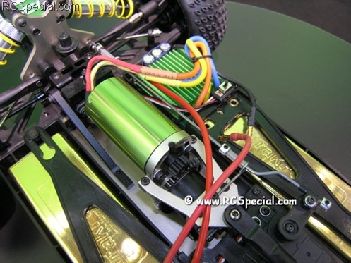

Hi,
I like me e-rct alot using my Fullymax 2200mah 11.1v. 25C lipo.
Since these are small in length (+/- 10cm) but low in mah I want to put 2 in parallel to obtain 4400mah.
http://scriptasylum.com/rc_speed/_pi...wiring_4.gif~0
To do this I want to modify the classic conversion to the following :
So I want a motor mount putting the motor above the rear drive shaft (making pinion changes easier) and putting a lipo on each side of the center diff. I can put my MM esc opposite the servo on the chassis (I use the Ofna extended chassis) the car better.
Problem, I need to find someone to make me this mount + battery trays which would be fixed to both chassis and motor mount. I would also try to make a top deck going from the front diff housing to the rear.
Below a pic of my current set-up.
ID:	6681   Click image for larger version

u could try and filp the center diff and motor mount 180 degree so that the motor will be in the opposite side of the servo , then ull have space at the back to pit 2 packs of lipo , although im not sure if itll work coz i dont have the stock chassis

Flipping the diff and motor won't work, cause the motor wouldn't fit between the motor mount and the steering post.
