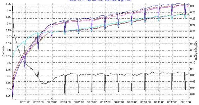

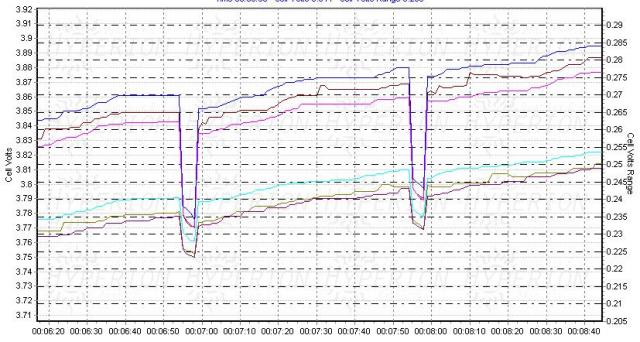

Here are some curves to make things clear.
Have a zoom in look
there are two groups of curves, cell 1/4/6 (brown/pink/dark blue) presents far higher voltage under 7A charge current, unless during charge pause period they get close. The "spikes" are 3 second charge pause every minute, you can see the "bad" cells have huge spikes compared to the good cells, reflecting much higher internal resistance.
Now the discharge characterestics, same result, the bad cells have large voltage drop under only 3.2A discharge current. the good cells(red/yellowgreen/light blue) have smoooooth curve(low voltage change when current varies) and are very close from each other, while the bad group are full of glithes and far apart front the good.

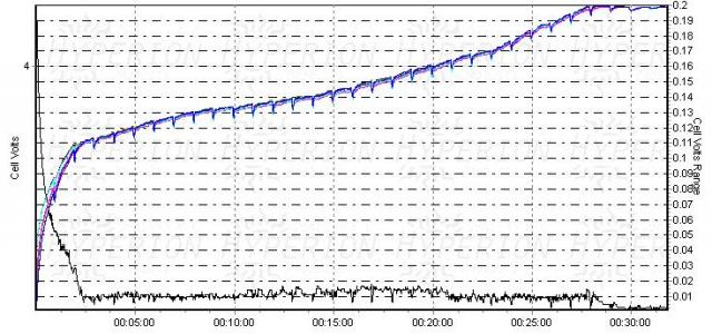

a zoom in look
For a comparasion, here are the curves from one of my other packs
all curves are close each other and have unique shape,
I am completely puzzled, what has made this difference? if long storage time harmed the pack, why only half number (3/6) gone bad while the other harf stays healthy? Any appreciatable suggestions to help me save my investment ?
