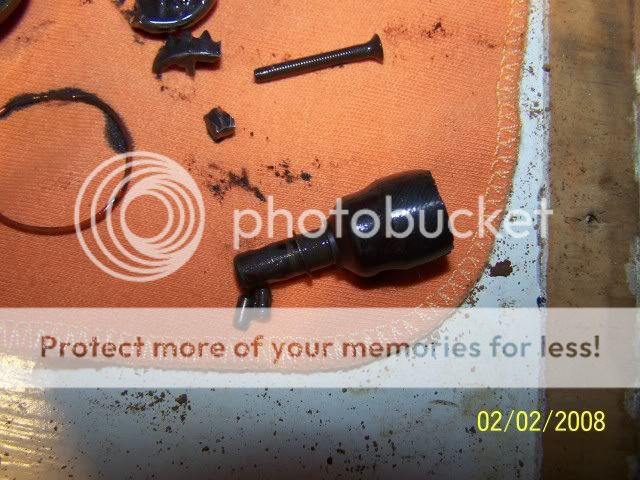

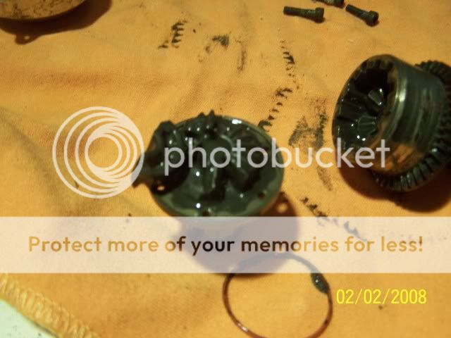

No problem man... how the hell did that happen to your diff? Let me guess... hmmmmmmm.. too much power? Hope you get it sorted soon.
Too much power (i think this may become part of my sig. for awhile)to be landing difficult jumps while hard on the throttle to correct with a locked slipper.

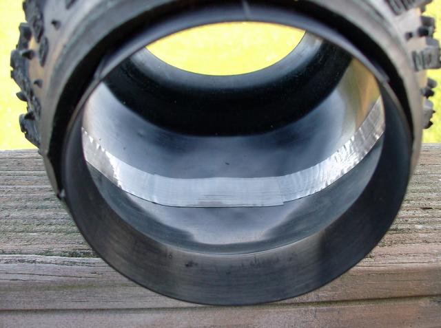

I had considered cutting, say 3 inch strips, and overlapping by like 1/4". It would be a headache I'm sure, but if you could do it inside the tire it would eliminate most of the wrinkling. I need to take one apart and just have a look and quit being a wuss about it lol. Strapping tape would be better, I have plenty of 3/4' wide fiber tape, but that would be a lot of pieces...
I know most people hate Zombie Max tires, and they do balloon at ~30. But after well over a year they show almost no wear. And traction that could almost climb walls...
Alright I finally did it. And pretty much the way I said...
I wanted to see if I could do it without inverting the tire. I managed to and they run amazingly true and balance is no worse than it was, at least.
I was able to get one full run around the center as the profile is flat enough that there isn't much wrinkling with the tape. As for the outer sections, in order to get it to lay flat I used 3-4" sections overlapped at least 1/4". You have to do a zigzag crosshatch type thing to get the tape where you want it.
Major handling improvement, and didn't lose much at all on speed. I was expecting about a 5 mph drop, but apparently the weight on my Mute was keeping the diameter roughly the same on the contact patch, even while the rest of the tire was playing pufferfish. I locked a front wheel to get 2X speed with the diff and got no sign of ballooning, so theoretically they should be good for 60+. Not happening, but nice to know.
Strangely after so long with minimal wear, they are showing wear after 3 or 4 runs with the tires taped
Not pretty, but very effective!
Cool cool I'm glad it worked out! I bet it took a while. Strange indeed about the wear. Is that some sort of tubing on the inside lips to hold the carcass open?

Those are the ring halves for the beadlocks. They were a huge help with taping, and I was careful to let the tape down slowly and not distort the natural contour of the tire. The tape made the tires significantly stiffer even unmounted, acts almost like a real tire carcass to some extent.
The beadlocks made things quite a bit easier vs. glued tires, and most of the time was just cleaning the shredded foam out and getting the tires clean inside. The compound of the ZM tires is like the rubber they make those wallwalker toys from, you have to pry it apart from itself, so the tape stuck like crazy. I'm not sure how well some tape sticks to the various compounds, but it worked great for me.
