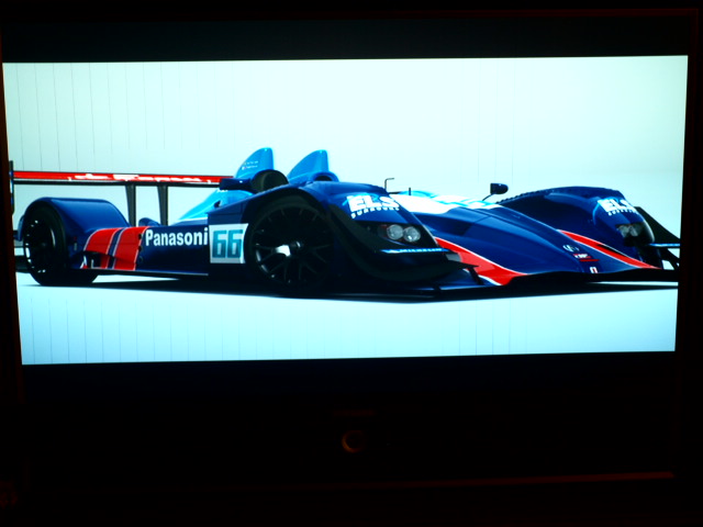

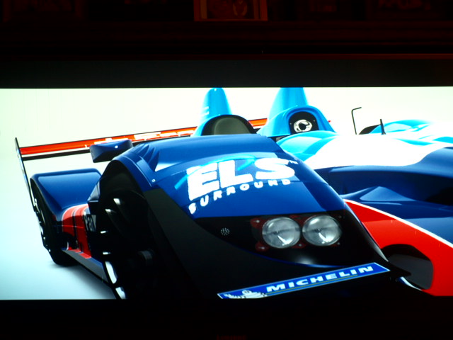

OK I know it' been awhile, I did some reworking/finishing touches on my 1/8 scale rock buggy and I also built a 2.2 Berg for comping.
But I have returned and have started on my horizontal shock setup for a few reasons:
IN the hopes of fitting on a more aerodynamic -better handling body this giant body really hinders speed and handling, I cant stop building and tweaking and I love the champ car F-1 car look.
If any of you has seen a thread or knows someone that makes polycarbonate bodies or there is a how to please let me know.
I would like to form/make a GTP or Similar body like below, pic taken from my Xbox360

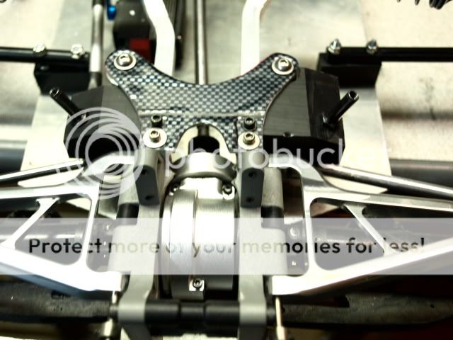

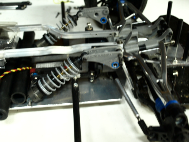

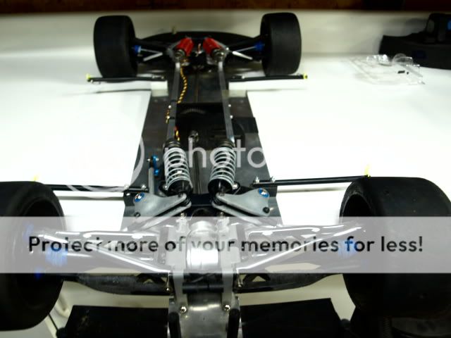

What do you think ?
Jut a mock up, I may make my own rockers so dont pay to much attention to angles.
Trying to be different here:
Should I lay the suspension on top like F-1 or stand up like first pics ?

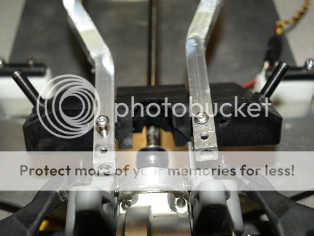

Preparing for a new low body.
The front turned out just ok, it was a bit tricky getting around the steering. I'll probably make a nicer one later. The rear one took a few hours machining in my drill press but it came out great.
sliding into place
Front Rocker bracket

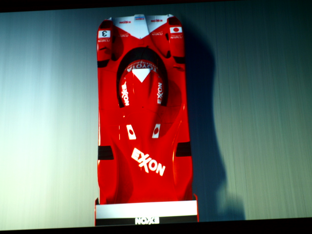

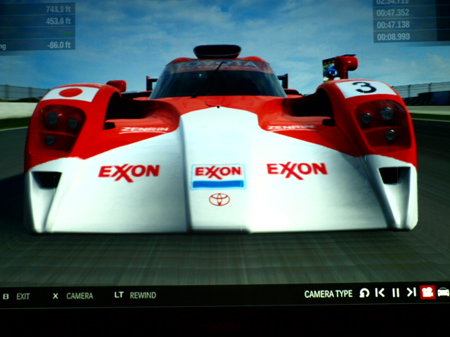

The new body I plan on making. In researching forming Polycarbonate it looks like money and time wise I will make a PVC body first.
Here's what I am aiming for

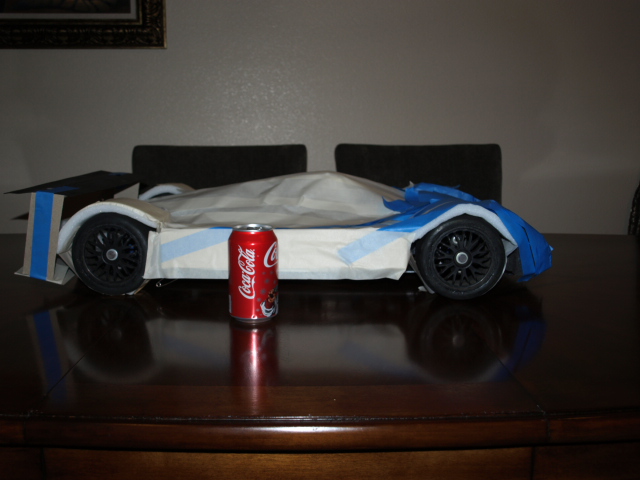

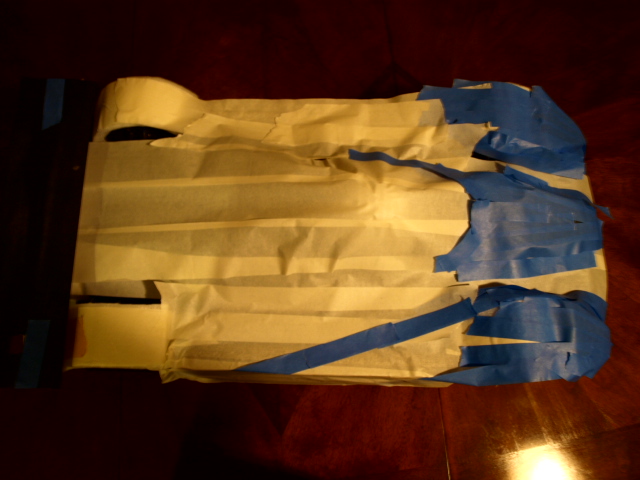

I have been researching to find a material to carve and form to but no luck yet.
Material looking at:
Polystyrene
polyurethane
blue foam
wood
Getting VERY ANXIOUS for a Sweet RACE BODY and went to town with foam and tape, just a rush job but damm I think it's going to look Badas$
WHat ya Think ?

Er, you realize that the bodies for the Baja 5T range from ~125 to like ~175? Just to put it in perspective.
Originally I used Sport works Auto cross tires, and there's no way I would spend $175. on a plastic body.
Why not modeling clay? Start by using wood to take up most of the volume, then put the modeling clay on top of that and work into the shape. This is basically how they do clay models of full size vehicles. Probably easiest to do details, etc. with.
Then you can do a two-step mold on top of that, then use that mold to produce your final plug for use in the vacuum forming process.
This is what I've been toying with myself as I need to widen a SC8 body to fit my RC8T.
