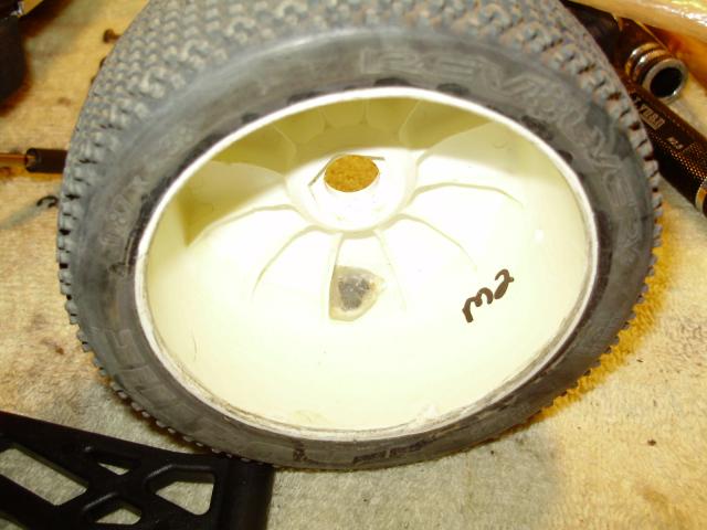

I balance all my tires also, I found the lead weights work very well and I secure them w/Med CA and accelerator.
Heres the balancer I have, zero set up needed. It's for 17mm hubbed rims but I can also do all my 23mm rims. I do this by adding some 1/4" tape around the hub to bulk it up for the 23mm rims .

I cut the size weight I need for a perfect balanced tire and stick it on w/the supplied 2 sided tape. Then ooze some Med CA around the weight and spritz w/the kicker. Too much CA will throw offf balance so be careful.
Buggy wheels will take only a little pieice of lead where as the big Ol' MT tires might take a 1/4oz or more
NOT argueing about the CA getting brittle, but I have some tires I balanced over 3-4 yrs ago and are still sticking like gangbusters ?
