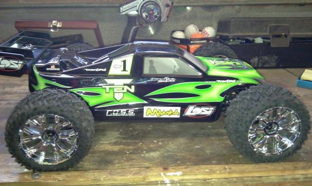

Got the kit Thursday, finished it up this morning. Have to say top notch quality as always, thanks Mike.

Thanks, you will be impressed. On the track it's better than my 8ight buggy, and bashing is just incredible. The zombie max tires work surprisingly well.
I hope they do a Ten-B, that would be the perfect replacement to their current 1/10th 4wd buggy.

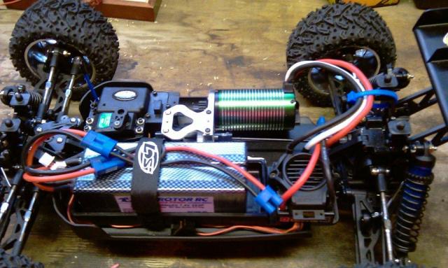

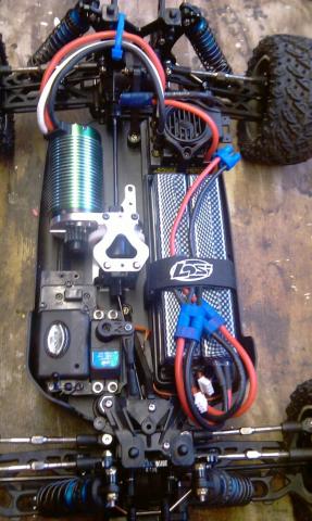

Installation almost complete, I would have had it finished last night but ran into a few snags. A few things worth of note:
- The battery strap included with the kit was too short for my application. Following further research on this forum I discovered longer straps are available. My fault. I just ended up buying the Losi straps at my LHS as I didn't want to wait for another order.
- I had a similar issue as IIICJACKIII with sizing of the screws. The original ones removed from the nitro parts were much smaller and a different thread size than the ones needed for Kit (both battery and diff mount) I ended up needing 5 M4 and 1 M3 screws to complete the installation. I figure no problem...so I head off to the LHS for some screws. Well I found out they don't sell screws individually and were only available in a kit at a price of $50.00!. Luckily I had a friend who had a few spares laying around.
Everything else was PERFECT! Thanks Mike and Brian for you assistance with this build. I can't wait to power it up.
Neu-Castle 2200kv
MMM ESC V3
20T pinion gear
2* 2s 5200mah 35C Lipos
Weight 7.2lbs (measured on a bathroom scale)
