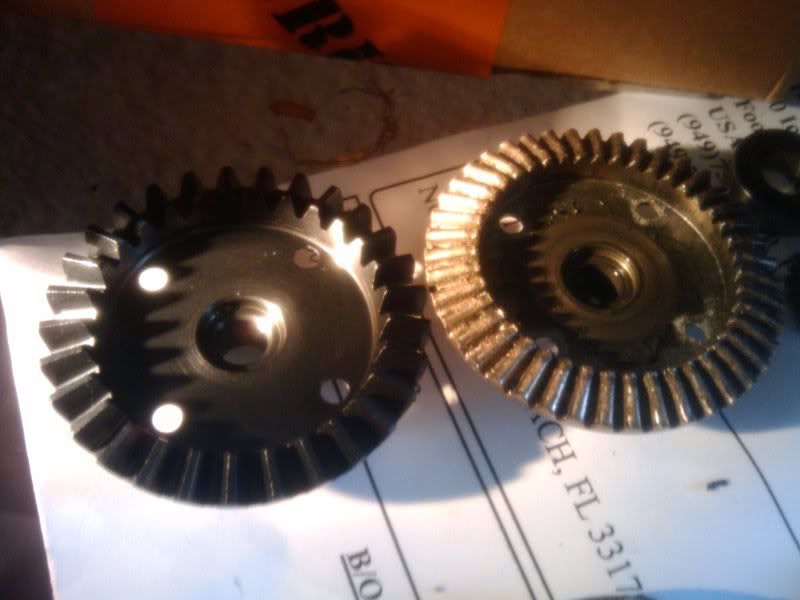

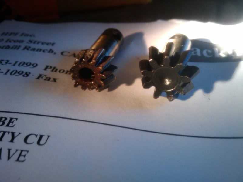

10.25.2010, 02:02 PM
"they arent any stronger than the xxl diffs, they are just a diffrent ratio"
I strongly dissagree,
look at this picture:
And this:
A stock 1/8scale savage diffs Vs BP.... No difference? Looks bretty much more beefy in my eyes

My problem isn´t that the pinion is "jumping over" a few tooths on the ring gear. The problem is that the tooths are losening from the ringgear..

Manne- you showed a side by side comparison of the SAVAGE XL diff and a BP diff, of which yes, the new bp version is stronger.
semipro was referring to a LOSI XXL diff, so your picture has nothing to do with what he said.

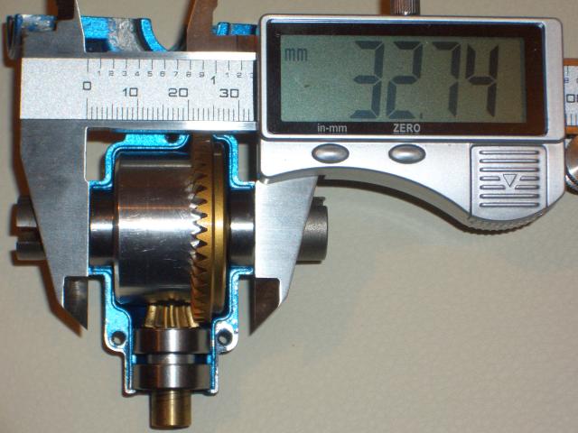

10.27.2010, 05:37 AM
Now we just need someone to meassure the Hpi BP diffs like this:
And then we will know....
