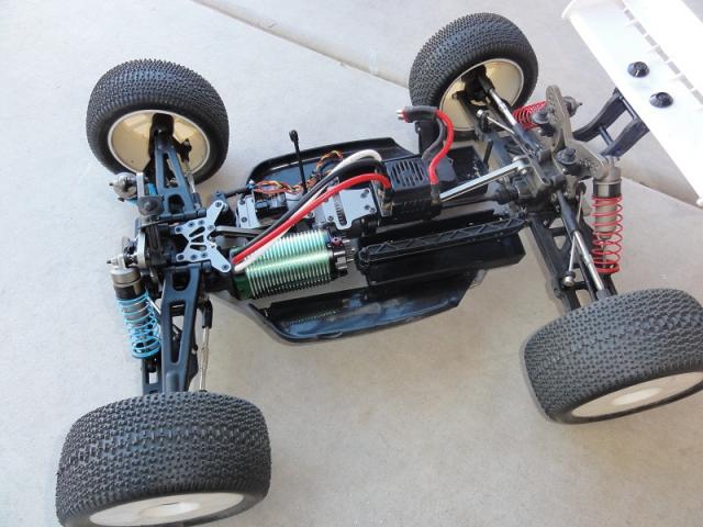

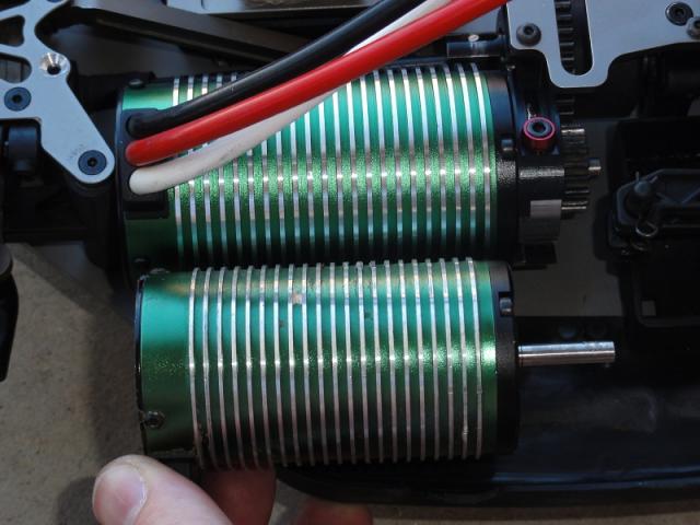

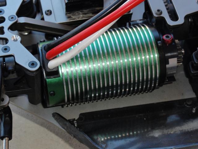

Ok,
I just got done with my Caster K8T conversion, which included stuffing a CC 1717 1580kv car motor into the chassis. I had to use an EliteRC motor mount from a MBX6 to get the proper motor clearance. With this mount I can run as low as a 15, maybe a 14t, pinion.
Now, I had ever intention of running the setup using a pair of 3S batteries in series so that I could acheive long enough run times to complete a 20 min main without needing to change batteries. I'll still likely do this, but for now, I have only 4S batteries, with the exception of a pair of 3S Zippy batteries that I only plan to use for testing until I can get some new batteries.
Would it be safe to run 4S in this setup? My 4S batteries are the Hyperion G3 25c 5000mah batteries. Or will the motor try to draw too much from them.
I'm currently geared 18/46. Here is how the speed calc pans out.

It definately looks like the 15t on 6S puts the RPMs in the sweet spot. Again, that is where I plan to be eventually. But man, 45mph is still a bit fast for racing.

Under hard racing condition (europeean track), my 1520/1Y 6S geared for 39mph (13/46) in my mbx5t truggy last 12 minutes with 6S 2950mAh 35C hyperion. I don't want to use bigger batteries because I want the lighter possible truggy.
IMO the 1717 is useless and too heavy for a truggy (80-100 grams more than the 1520). The best truggy choice is (for me) the 1520/1Y. I even run a 1520 in my buggy on 4S, a little heavy (60 gramms more than the 1515) but very efficient.
