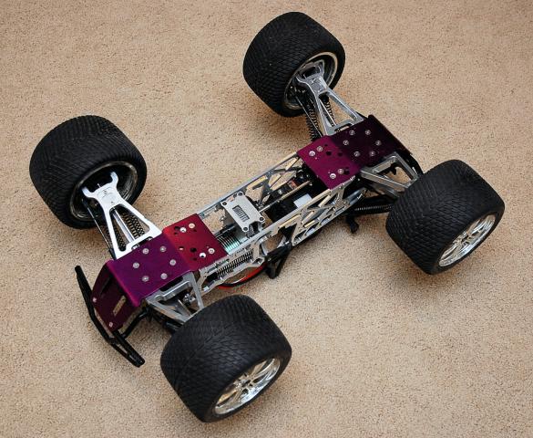

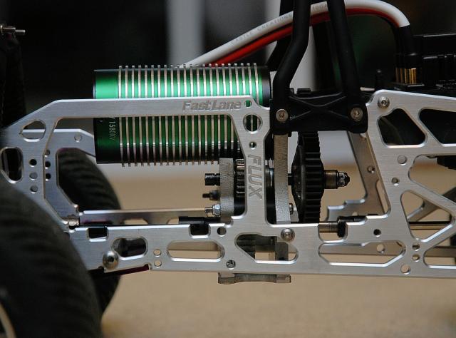

Here is my first savage conversion. I still need to mount the batteries, upgrade the shocks, and possibly support the back of that motor. I don't feel to confident with the weight of that 1717 and the way the KD Gen 2 tranny is mounted. I had to have the tranny post machined to adapt the 4mm screws on the 1717.
I have about 10 runs with a CC1518 motor on 4s and the truck was a blast. This should be a new ball game.
- CC 1717 motor
- MMM ESC
- Futaba 3PM radio
- Turnigy 40c 5000 3s lipos
- Kershaw Gen 2 direct drive tranny
- FLM chassis
- HPI bullet proof diffs
- Lots of aluminum

Only 4 screws holding the kershaw tranny in place? Looks weak, the rest of the truck look great. 1717 is heavy... And powerful!

Ya the 4 screws worries me. The weight is very uneven with that coke can sized 1717 hanging off the side of it. I'm trying to think of a way to support the back of the motor with a bracket.
George16- I still haven't tried the truck with that motor yet.
I'm anxious but I'm still trying to mount the battery packs. I really didn't like the Flux battery boxes so I picked up a pair of Tekno boxes and straps. The problem is the FLM machine chassis is like swiss cheese so I'm having trouble attaching all 4 mounting locations on the Tekno boxes. There is very little metal to work with. I may have to go back to the stock boxes.

I haven't tried the 1717 yet. I did try it with a 1518 before I snapped the old graphite chassis in half.
Matfew- Just a heads up the 1717 does not fit nicely in the V2 tranny. It required some machine work.

Still weighing up my options atm. I know the 1717 is going to shred the tranny so deciding on what to do.
Was reading about the ofna CD also another member here done. Seems like the way to get is some sort of centre diff.
01.02.2011, 07:12 PM
I see no reason the stock flux tranny will not last... It has all metal gears. Sealing the halves of the case with some rtv silicone and running some oil in it would help. The lucas or stp oil stabilizer is a favorite with a few members here.
Keep in mind how fast these gears turn, it crates alot of heat. Some oil on the gears will help with both heat reduction and lubrication. The oil stabilizer is sticky, so it stays on.

My "phase 2" plan is to go with a center diff. I'd like to see what others have used for center dogbones with a center diff. I bought the truck with the KD tranny already in it. It was someone elses project that was never finished.
I don't have high hopes for that tranny with the 1717.

TVP Chassis braces and a slightly bent skid plate to acccomodate the bottom of the KD Direct Drive. Mounting it taller to allow regular skid plates would make more sense tho. Most people have the plastic brace bar to protect that area anyhow.
And as for support for the larger motor, what about a TVP brace or 2 with a little half circle cut into it, with the motors dimensions -- to make the braces hold the motor nice and tight. Would require a bit of modding though. Would need to place a brace on each side of the TVP, since there are big holes on each side. But would be doable with 4 TVP braces or so, 2 screwed on each side of the holes, 2 more screwed onto them for motor support.

I have the new RPM center skid plate installed now but it looks terrible. It covers the tranny however it's bowed like a wet piece of wood.
I think I understand what you mean^^ as far as braces. These TVP's have huge openings for what I would assume is the stock locations for the motor in a flux. I wish I had a little more meat to mount some braces.
I think the plan will be to drive the truck for a bit and see what the KD tranny does. If it holds up fine I'll design new TVP's in Solidworks and have them made. They would accomodate the changes I want to make such as raising the tranny up.
If the tranny explodes then I'll start designing a center diff layout.
