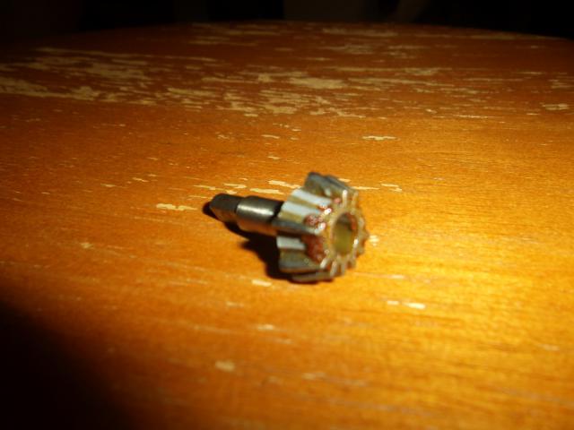

of the rear pinion gear in my GTP. Blowing the dust off the chassis doing a few full speed runs up and down the street, I rear end sounded and shook terribly. I broke down the rear end and found that 7 teeth had been broken off the differential pinion gear. I love the power but hate the inconveniences it causes. Upgrade time.

True Monster. Do have the hardened diff rings?

I will soon. The gear ratio is going to be lower also. The stock is 3.30 but the new ratio will be 44/14 or 3.14.

Worst part about the K series diffs, they just do not hold up all that well... I did the same on my mbx and gtp. If you shim them just right and run some good synthetic grease they last longer.
