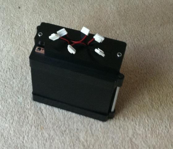

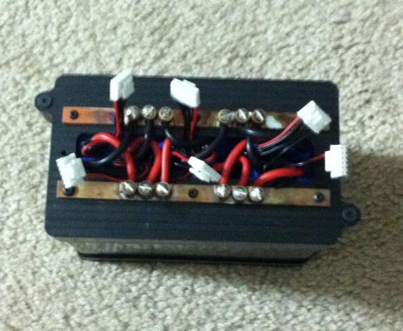

battery modules - 09.19.2011, 07:01 PM
The battery modules I built have a similar form factor to the lead batteries - yet each module has 1.5x the voltage and almost 4x the usable capacity while weighing 3.5 pounds less. 4 modules also will replace 6 lead batts, yet the energy gain is even more significant than the weight loss(and both are very significant).

The modules allow removal of any individual pack without disturbing any other pack. I can also balance charge each module, as the balance leads are exposed and can be connected in parallel with a 6-to-1 balance lead. I balance charged each pack individually before assembly and will balance charge each module every 5-10 cycle once on the bike.
Very nice battery setup Mike! Those are Hyperions, aren't they?
You should get more than 100 cycles with Hyperion Quality.
I really like the boxes.

09.19.2011, 09:51 PM
Yes, the packs are Hyperion 25/50c 5s 5000mah - 24 of them altogether. I should easily get a few hundred cycles out of them as they will only max out at 10c discharge and won't be over-charged or over-discharged. I don't plan on beating this bike into the ground, either(my other dirtbike takes a thrashing, though!).
The boxes took a few days to engineer and a couple days to build - making them again would be much easier of course. I had to re-engineer a few things as I progressed through. I like the system, though and will modify sizes and utilize the same strategy more in the future now that I have a good grasp of the processes.

You were talking about balancing each pack of the 30ah module. Wouldn't it be easiest to parallel the balancing tabs?
Then each of the 6 parallel packs would equalize to each other at all times plus you could balance all 6 as a unit.
This could serve to increase the life of the module.
I thought he said he uses a 6 to 1 balance lead?? That means they will eqalize during charging (as a module) and still be easy to assemble/dissassemble.
