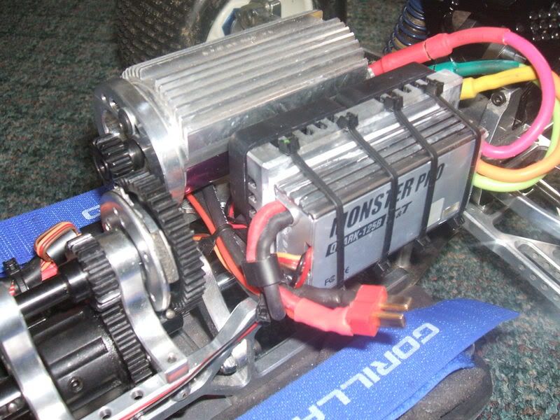

this is how i have my quark mounted and it works great, and stays nice and cool, also on the backside of the heatsink is (2) 40mm 5vdc fans.....Also the heatsink was drilled at tapped on the side of it and mounted to the rear ext plate as well as thermal paste was used too.....
