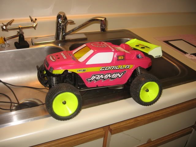

every thing is here except the 3s battery(shipped today) and i put it together and tried it out on 2s, a little slow, but i could gear up to 18/46 im at 15/46 now, temps were great so far, 95f for esc. and motor
thanks for the recomendation BrianG, this should be sweet on 3s
here it is ......
btw: should i get the rc-monster heatsink for this???
the can looks the same as the xl so i guess i should
cant wait till the chassis comes out in the store for this!!!

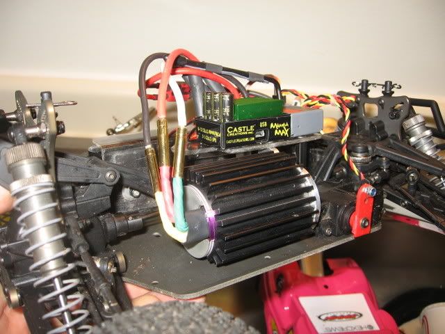

I don't know if you have changed it from the pics, but make sure you cover those motor connections. The ESC will let out that magic smoke if they touch!
  (#36)
10.06.2007, 01:28 AM
I was wondering the same thing, but then I saw the "unshrunk" heatshrink tubes on the wires in the second pic. But yeah, definitely isolate those suckers!
  (#37)
entjoles
10.06.2007, 08:52 AM
yeah i did shrink them, that would suck to smoke the esc., 3s battery is on its way, and i think i may get the rc-monster chassis once it comes out in the store
