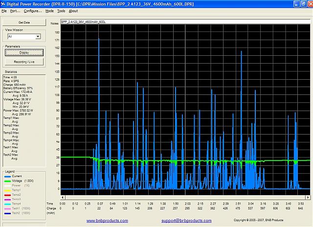

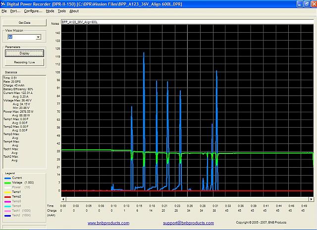

Here are 2 graphs that I got from my DPR. One is with 2 36V packs in parallel and the other is with one 36V pack. BTW the truck was geared to go around 165-170MPH LOL.
