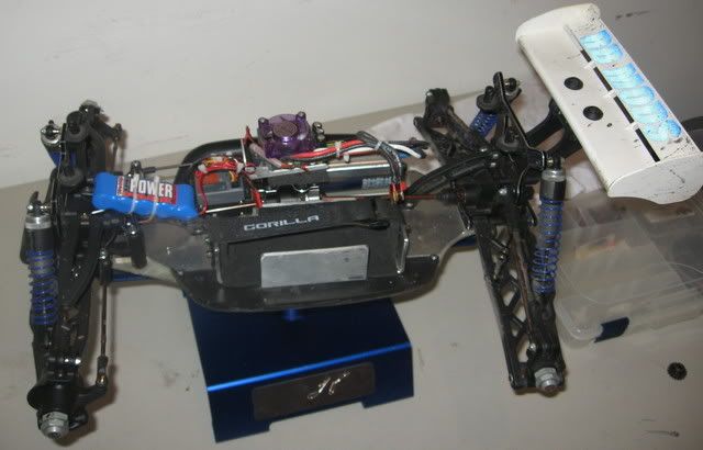

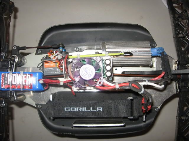

heres some pics
i just have this thrown in here for testing, i will be makeing a new esc. plate to mount it farther back and look a little more tidy
and will upgrade to the MMM when it comes out, this is my winter project so i will post some new pics once i get it finished
