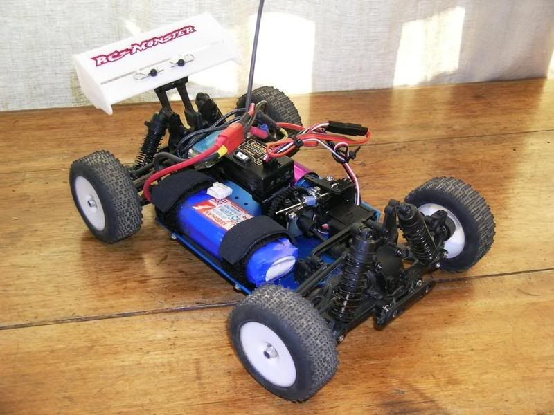

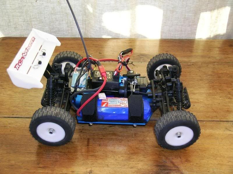

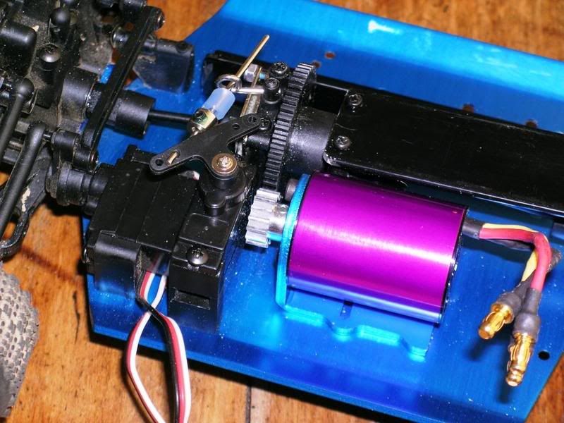

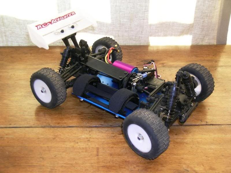

02.09.2008, 01:31 PM
My Chaos brushless conversion: E-Chaos
Waypoint 25A ESC
380S 4500kv motor
Stock servo and disk brakes
MQ motor mount
Hyperion 1800ma 3S battery
I think the stock diffs won't last too much.
