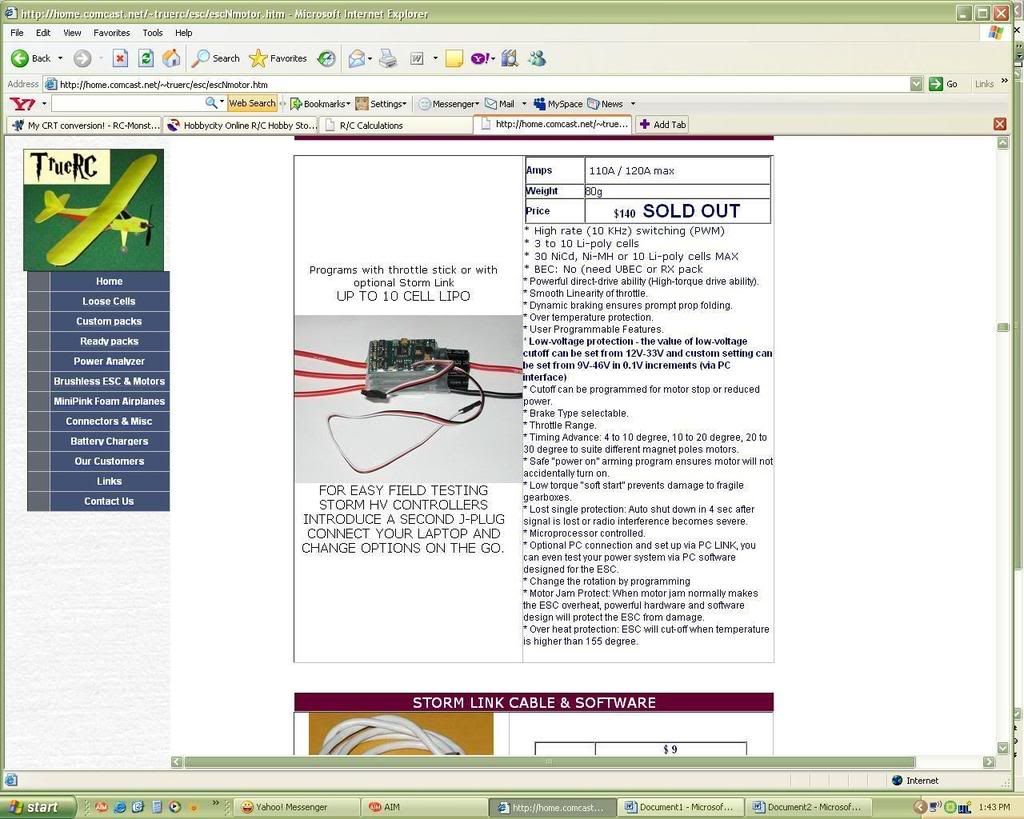

inexpensive alternative to a hv110! $140!
inexpensive alternative to a hv110! $140! - 03.01.2008, 05:48 PM
its from true rc. check it out
03.01.2008, 06:07 PM
I wonder if that ESC has the slow ramp-up in throttle that plagues other low-cost air ESCs?
The HV-110 can take bursts near and over 160A. And that's from Joe F at CC in an email. This one says 120A max.
Seems ok for a high V, low A setup when you KNOW the current will be low (even bursts).
03.02.2008, 02:57 AM
120a max is the continuous, IIRC. not sure on the burst.
03.02.2008, 03:20 AM
To me, it says 110A continuous, 120A max. By "max" I assume sustained bursts. This is generally how most ESCs are labeled...
03.02.2008, 12:36 PM
yeah... being an air esc i guess the low burst current is a given. but for 1/2 the price, there should be a way to rig 2 of these esc's for a 110a, 20s lipo configuration. now that would be cool.

Are you saying two ESC's for 1 motor? Or dual ESC dual motor config? Would be nice to do a dual ESC on 1 motor.....I would go 14S lipo /dual 7S wired to 1 Neu 1527 with 860KV's......mega power.
03.02.2008, 02:29 PM
Yeah, but that one already has stacked boards. To double it would mean stacking already stacked FET boards and might become too think and a little cumbersome. I was looking at ESCs that had a good 100A rating on ONE board, and then stacking two of them.
