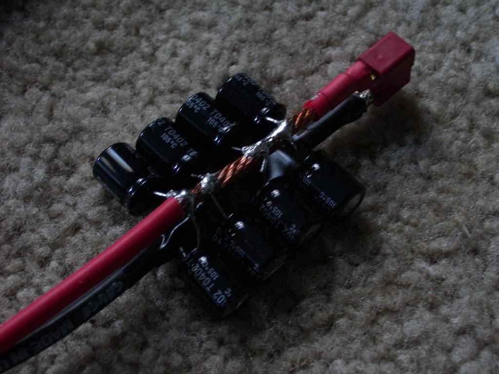

brushlessboy16
brushlessboy16's Avatar
05.26.2008, 08:01 PM
if you own some wire, and a soldering iron, all u need is the capacitors,
http://cgi.ebay.com/330uf-100v-Radia...QQcmdZViewItem
i made one, really easy to do...

brushlessboy16
05.27.2008, 04:18 PM

lutach
lutach's Avatar
Posts: 5,139
05.27.2008, 04:27 PM
Yes, great example right there.
