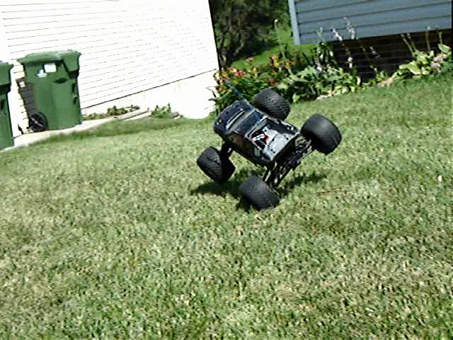

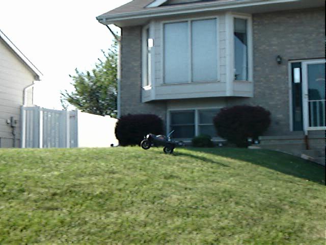

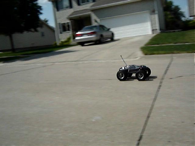

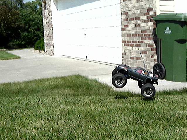

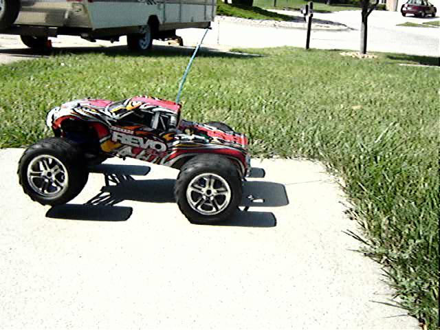

Gearing up to 19/62 helped quite a bit. Today I ran for 30 minutes with it being 95f outside.
Motor 1: 190
Motor 2: 180
ESC 1: 160
ESC 2(BEC circuit): 175
The two runs added together I get about 45 minutes runtime with the FP 4270 3s.
I'll consider those acceptable temps especially with how hot it was. Will be getting a back-ordered E-revo chassis in the mail tomorrow and installing it. Should help tone down the wheelies a little.
Taking more clips to put together a better video. It will most likely have the 9xl 3.3 Revo if that is running before filiming is complete. Gonna put some good editing into it, and most likely stick the curved ramp in the middle of a field for some jumps.
Also: With dual V, I opted to stiffen the springs to Silver in rear, Tan in front. Have the P1 rockers still on for the 2.5 Revo. Works really well except it tends to be a little bouncy, I'm planning to upgrade to 45 wt. shock oil to help keep it planted; I'm hoping this will allow me to get some air time in and still be able to absorb the landings.
Some stills from the footage I took for the run:

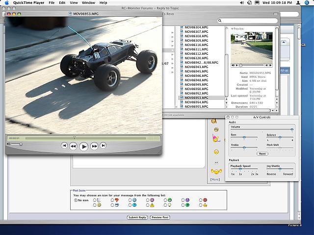

The E-Revo chassis is installed and I still have the E-maxx motor plate on the tranny so the motors are mounted pretty far forward. I tried to counteract that a little by sliding the batteries all the way back in the boxes, still a little front heavy, but turns great. Wheelies are definitely less abundant with the low CG batteries and extra wheelbase. It just spins the tires on the street. Looks awkward with the old 2.5 body on there
