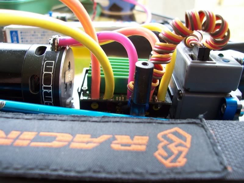

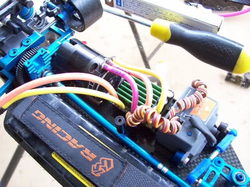

After i finish the new wires, ill post pics of the esc & also how it was soldered to the board...

UPDATE
I successfully fitted 12awg wire to my MM. i used an 80w iron, i kept my fingers on the heatsink of the esc so i could monitor the temps. the 12awg wire fitted straight into the holes, even with the wire tinned & the solder tab holes tinned. i ended up using 60/40 rosin core, & cleaned all the old solder out with a solder suck.

in the background of the first piccie, ive got an elite 4800 25c 2s from cheapbatterypacks.com, awesome pack, thinking about grabbing another one from there again aswell...
