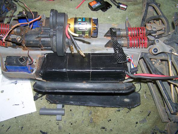

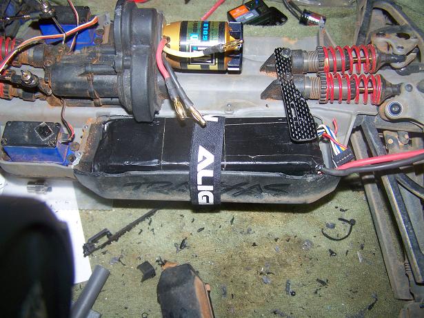

I have started working on the chassis so I could fit 2 25c tp 4s 5000 packs on the truck in parallel,runtime seems to be about 20minutes on the 2 2s packs.
Hoping 2 4s packs would increase the runtime past 30min.The state races we have here in florida runs 30min a-mains.
I think I would do better doing the stop-n-go's for pit stops rather than changing packs mid race.It is turning out pretty good so far.
I have to get another tp pack though as I only have one at the moment

here is a pic of my progress so far,I have another chassis I can go back to

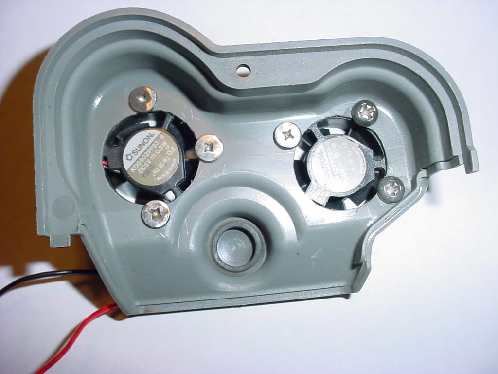

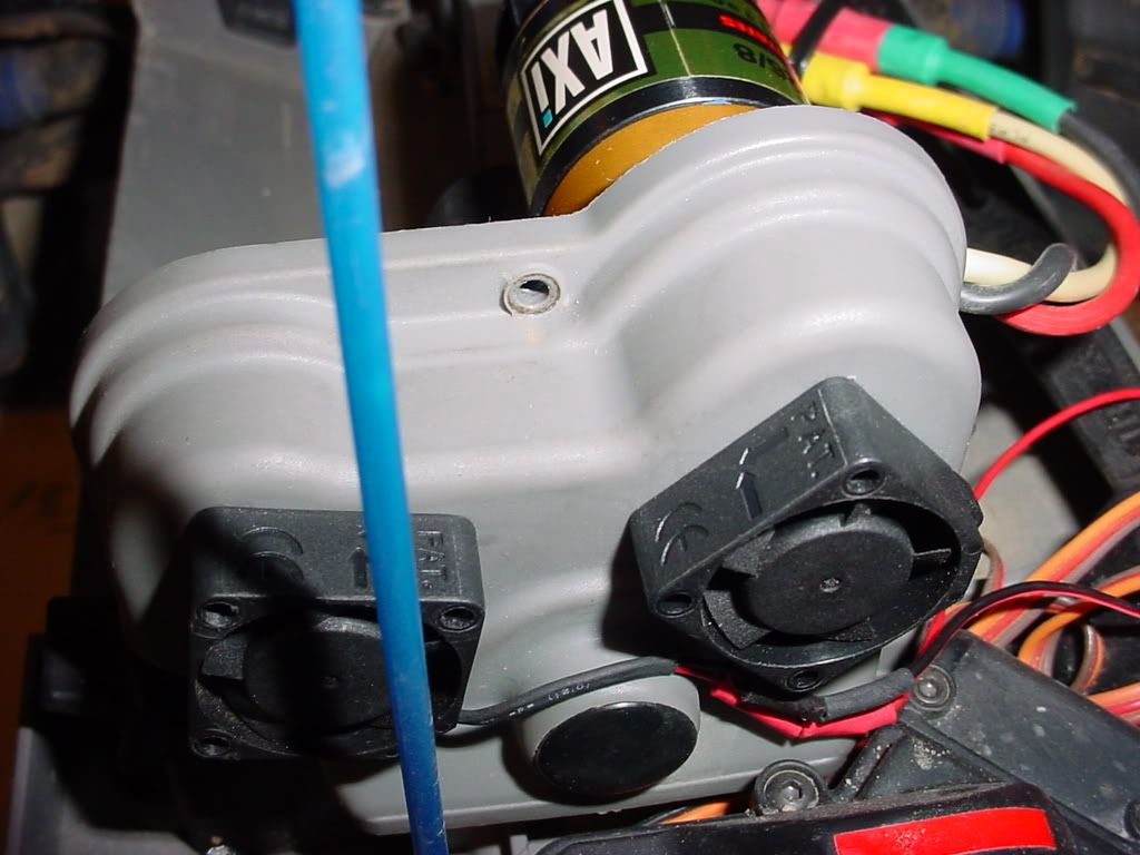

Here is a mod that I did to the E maxx. These fans help cool the slipper clutch area and also blow air on the other side of the motor plate.
Perhaps you could come up with something for the E Revo that would help things.

That looks pretty good,I will be removing one of the steering servo's to offset some of the weight.I'll be installing a ds1015 servo.
All in all the weight should be the same or little lighter when I'm done compared to stock setup with 7cell nimh packs,truck is a tank setup with nimh's
