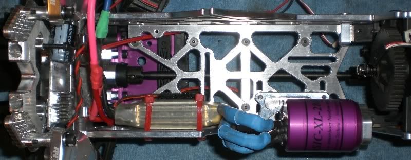

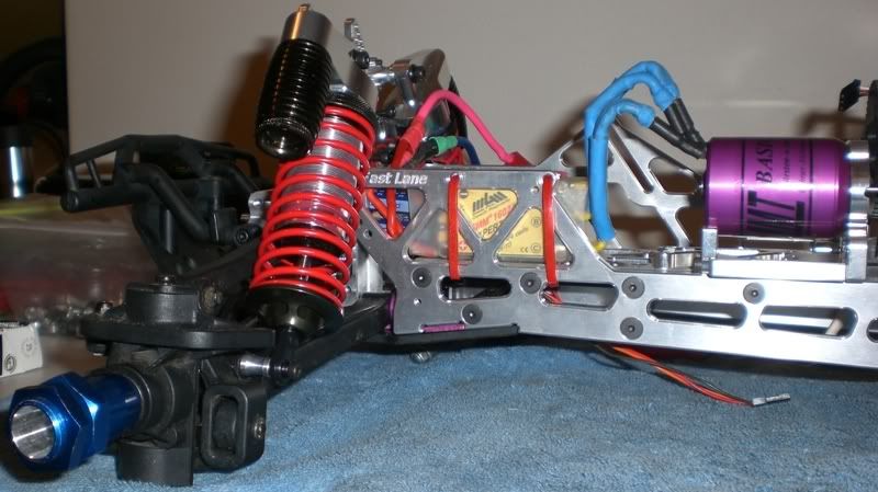

danhfvcsd
08.04.2008, 06:39 AM
Originally Posted by bl-is-future View Post
Especially in the FLM chassis where everything is inside the chassis anyway. You can take the ESC mount off and flip the ESC on its side and you should be able to keep the ESC completely inside the chassis. I will try this tonight and post pics of what i am saying.
you mean like this? =)
(Before you say anything - i know the motor is too small - it's just there to fill the space till i order the 1950... but i MAY be pushing it with the esc there - it may have to deal with only about 10mm of wire and a plug in the end for the motor to make room -lol-)
dpb318
08.04.2008, 11:26 AM
thats a good idea with the esc...but wouldn't a mm cool better if it was vertical because of the fins being on the top and heat rising and all that...and in my case i dont think i have enough room to put the mm and fan inside the chassis with my 8000mah lipo

bl-is-future
bl-is-future's Avatar
Posts: 974
Location: Midland, MI
08.04.2008, 12:33 PM
yep like that but i tried my MMM and it wont fit with a 5s with the spacers installed but i think it would with a 4s batt.

danhfvcsd
08.04.2008, 06:20 PM
at first, i tried to use those spacers, and failed miserably...
What did you do when you got to lining up the TVPs/chassis to the bulks/skid etc on the front and rear end???
The thing i dont like is that wasted space beneath the esc mount, so i am considering setting it up like this - the capacitors are quite close to the bulks tho, although i can probably slightly bend them out of the way... will have to wait till i get the 1950 before i can make any decisions from here tho...
