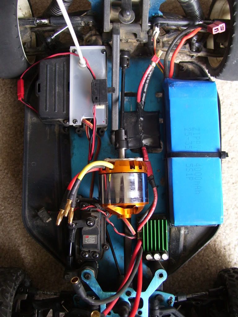

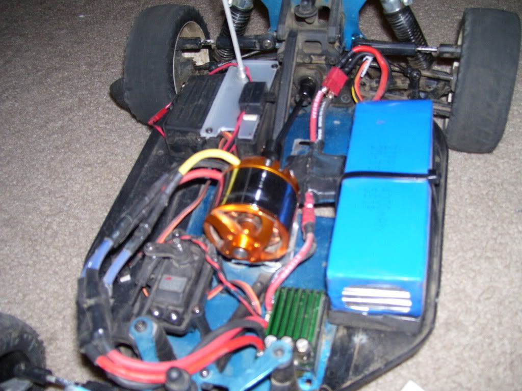

Turnigy 50-55b worked well
If you Plan on using dogbones for center drive you need an outrunner with an 8mm output shaft size, if you want to use sliders you need 6mm
This axi would work- http://www3.towerhobbies.com/cgi-bin...?&I=LXPPY0&P=0
Or this Turnigy 50-65 http://www.hobbycity.com/hobbycity/s..._380Kv_/_1820w

11.02.2008, 09:10 PM
11.02.2008, 09:48 PM
What happened to 4WD?
brushlessboy16
brushlessboy16's Avatar
11.02.2008, 09:50 PM
it was there after that pic
