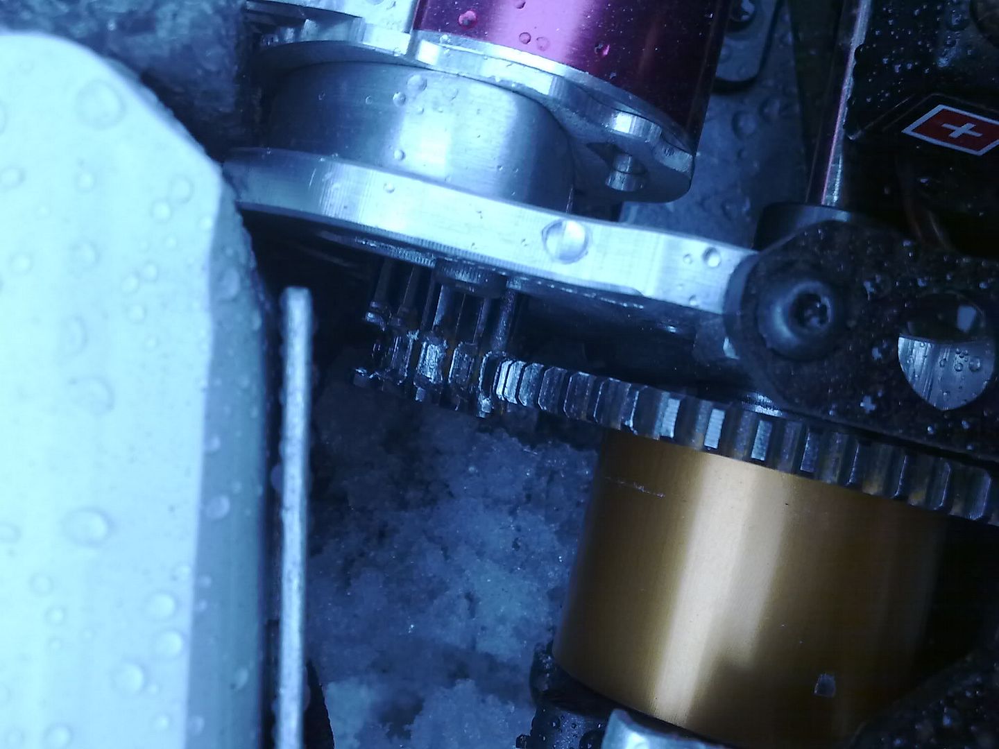

While waiting for my Medusa 80mm to be finished, I put torsen in center...
Torsen it self is by Hong Nor, gear is from HPI Hellfire and is modded to fit that torsen. With that torsen, i had to get rid of mechanical brakes, as that torsen didnt had outputs that would fit brakedisc's, anyway those were just for "just in case".
Here its fitted to chassis, that gear is 52t and it fits chassis if you raise centerdiff about 1,5mm.

Got my Medusa 80mm 2200kv today, with 4S its just great, it never got over 25C with heatsink and outside temperature ~-5C, running 14/52 gears.
I had Keda motor in it just before, and it had temps 45C with 12t pinion, some difference there, Medusa is solid quality.
I have HotRacing pinions, just keep away from them, if you dont own blowtorch, as those are not hardened. I just stripped that 12t...
Now i have hardened 14t and its durable.
