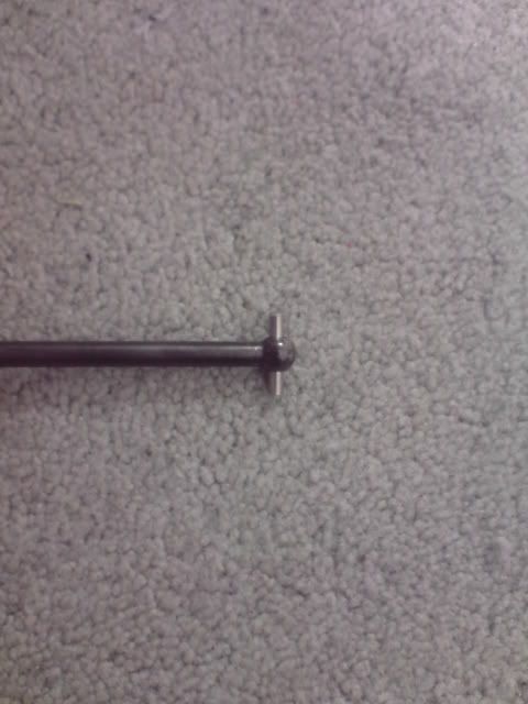

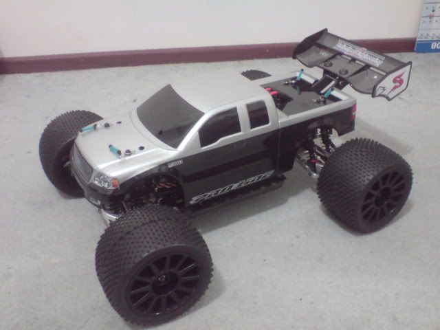

i got my cvd back tonight. My mate turned down a 12.9 hardened steel bolt on the lathe to fit perfectly. For some reason the 3mm pin i had didn't fit, it was too small, i think it ended up being like 3.1mm or 3.2mm i needed, makes a big difference. I also got done trimming the F-150 body to fit the truck. Hopefully the temps stay cool with that on, but i think im going to have to cut a hole in the windscreen evenutally. Taking it out for a run tomorrow, hopefully the batteries perform a little better on their second charge.

Oh, and notice anyting missing on the truck?

I see what's missing!! its the.... N10ah...

Ah, true, but i always tuck that under the body, its something(s) a little bigger...

Is it the front bumper?

I replied to your post in the traxxas forum regarding the pin. I had used 1/8" through-hardened ejector pin left over after making my hinge pins. 1/8" = 3.175mm.

You got it BL_RV0, the front and rear skid are gone. Replaced them with alum skids that i chopped flush with the bulks, probably wont leave them on permanently, but just trying to save some weight for the next run.
@Lito, I'll keep that in mind next time, they would have fit perfectly, saved me a whole lot of waiting time
