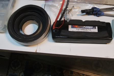

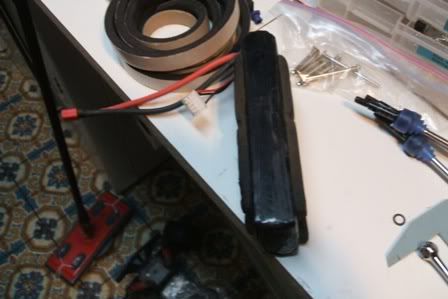

Anyway one thing that helps hold my batteries a little better is I use door weatherstripping on them. When I strap them it it gives a little cushion or compression area so I can snug them down better. It really helps more on the flat chassis I have with out a tray though. Like the FLM chassis.
These are some old pics but might spark an idea how it might work for you.
Oh hey, check out my super swifter sweeper or what ever they are called. The red broom handled item to the left. I took it put some little wheels on it and attached the magnet from a 75 watt pioneer speaker to the bottom. Drop a 3mm screw on that tile patter and it's gone if you take your eye off it. I use to waste too much time looking for them. Now I just get a different screw from the bench and later on. Take the swifter and run it around a few time and get back a bunch of my screws, bearings, body clips, all kinds of metal things. Treasure hunt.

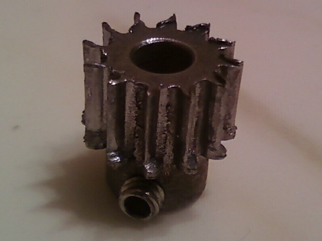

hey, just wondering, did you get those steel gears yet? I'm running a similar system in my hyper 7, and had some bad experiences with spur/pinions but im working great now... at first I had a non hardened steel pinion and a plastic spur. the motor came loose, chipped out 2 teeth, but the next time i really gunned it it shaved the spur gear. i put a modded CEN 46t spurgear(cheapest spur i could find) and created the shank-a-ma-pinion! now I'm running all hardened steel, 13/46 and it is honestly no louder than the plastic spur gear! although it may be because of the plastic spacer that it is so quiet...
the bald spur
the for some reason super quiet modded CEN spur gear
