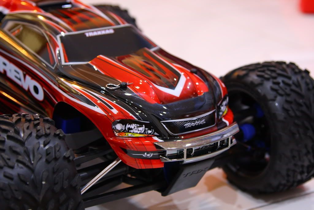

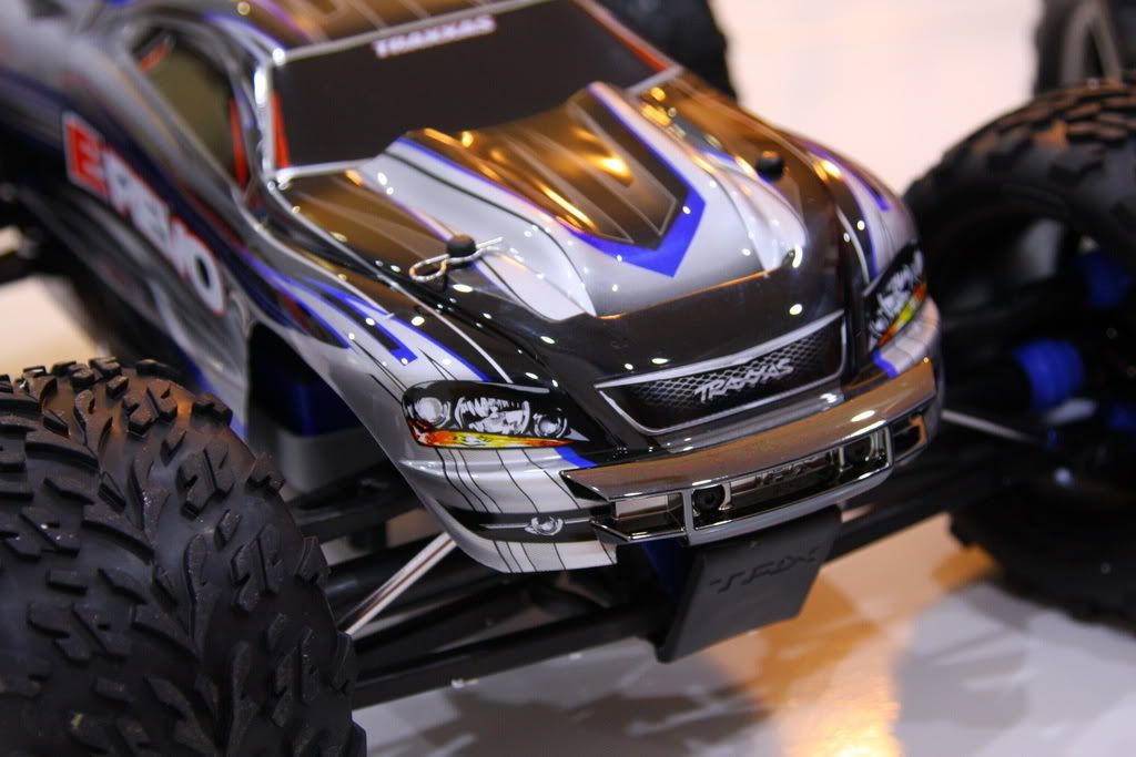

Ok they're here. My boy chose the blue one while I get the red one.
I've just gone through the manual briefly & it seemed there's quite a lot of tuning options available to the E-Revo especially on the suspensions.
Anyway, just made up 2 packs of 7 cells for myself while my son gets the 2 6 cell packs. The sway bar kit I ordered is incomplete. So, I guess I'll be getting the Tekno ones in the near future.
I have changed the springs to the LT springs as the original ones were just too soft. With the heavy Nimh batteries, they sagged badly.
The next upgradefor my truck is to slap on some BL power. My son's will retain the stock power/drive combo until he becomes better. I already have a spare MMM, Neu 1515 2000KV motor. Still trying to figure out what configuration works the best for this truck.
I have since slapped on some half offset LPR Crime Fighters on one of the trucks. Hmm, it looked kind of wide not proportionately correct. What sort of wheels is eveyone using ? Normla offset, half offset ? What works good & looks pretty ?
