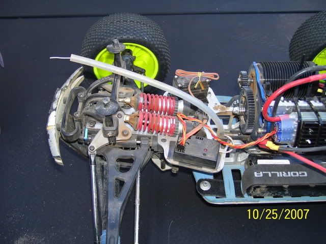

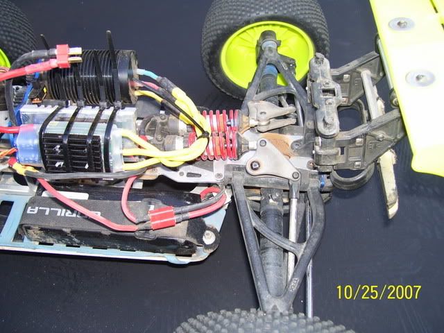

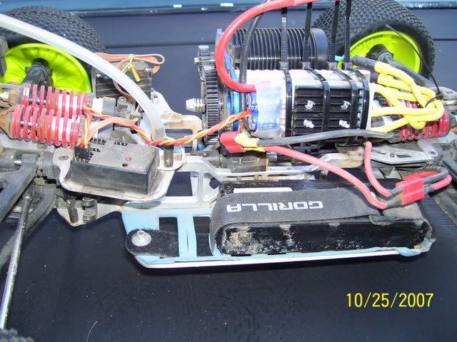

Originally Posted by TDC57 View Post
Ok here you go, these were the last pics i got of my truck. as i had said, she's seen better days.
[IMG][/IMG]
[IMG][/IMG]
[IMG][/IMG]
[IMG][/IMG]
